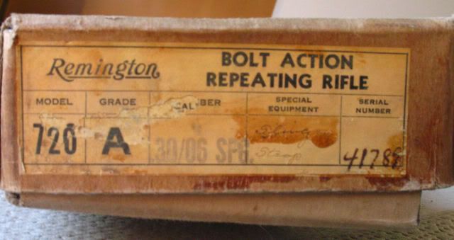

                      I don't believe the 721/722 came out until after WWII. I believe it was the Model 720 that the government bought and later used as trophy rifles.

                        [QUOTE=Herschel;58673]I remember seeing Remington 721's that were trophies for winners at the National Rifle Matches, Cp Perry, OH in the late 1950's or early 1960's. I have read somewhere that the Navy had a large number of the 721's. I seem to recall that the Navy had them for award to high navy shooters but am not certain.[ I believe I read The trophy rifles were 720 Remington 30-06's . There is one on Guns America.
                        • Binew
                          • 29
                          720
                          Just a note of agreement on the trophy rifles being model 720's
                          binew

                            Dave - are you are thinking Remington 720's - - -
