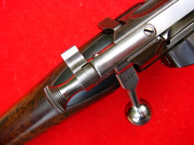

                  "A left hand spin barrel would work best in the Northern Hemisphere and a right hand best in the Southern Hemisphere."
                  Hmm....my 1910 dated Norwegian Krag has left-hand twist. I'm going to shoot it this weekend!

                          This makes my head hurt. I'm still going to shoot the Krag this weekend. ; )
