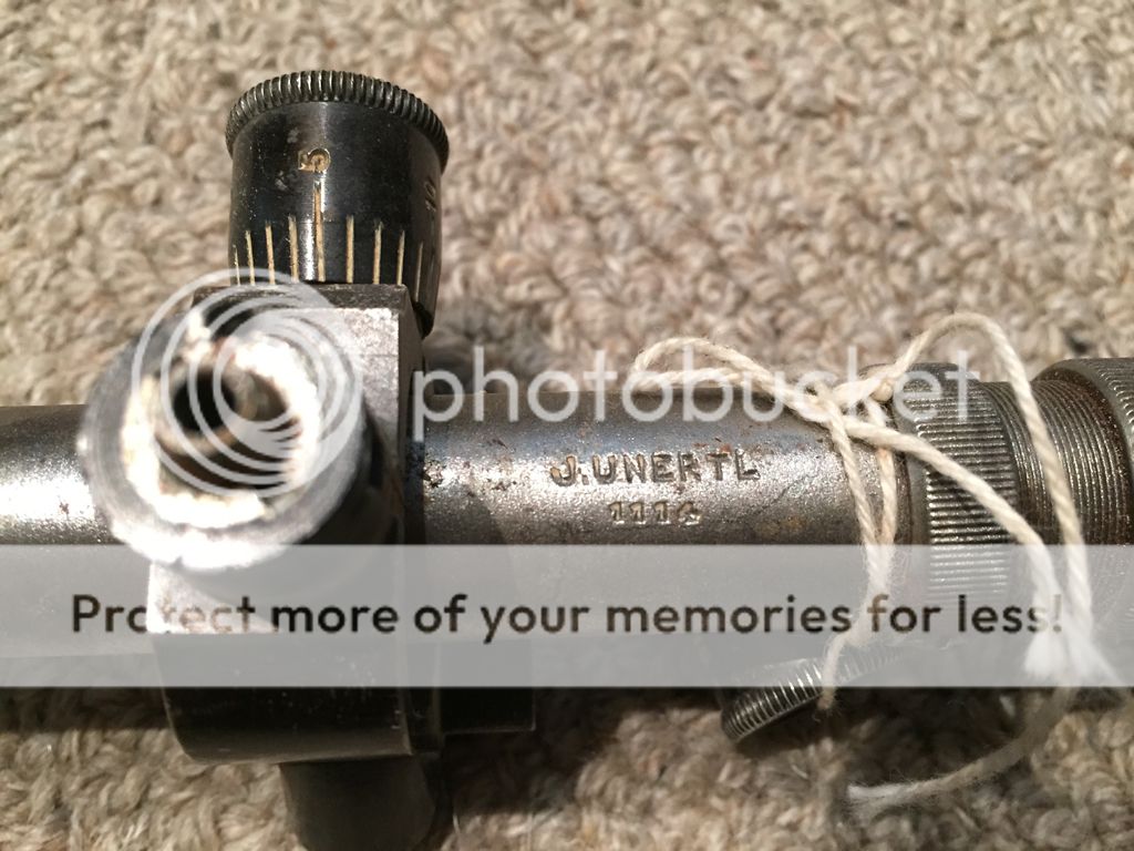

                      I have a special interest as I have an Unertl 8X scope, without the spring (as per USMC standards), with USMC mounts, with the USMC Micarta carrying case and with a serial number within the range quoted for UISMC-SNIPER rifles. It was bought in a military surplus store about 2008. It ended up in the hands of a former USMC sniper instructor and he sent it to me. The puzzle is that the scope is marked "1114 / J. UNERTL" and has neither the classic "USMC - SNIPER" marking nor the "J. UNERTL / OPT. ... CO."commercial logo. It is in rough shape having been submerged it looks like, though the lens caps were still on and the insides remained dry. The large end cap (objective lens) was rusted in place in it took weeks of soaking in penetrating oil and judicious work to free it up. A previous user/owner had used a wire wheel to clean off the rust and there is no finish left on the exterior. As one reader on another forum (Milsrups.com) stated, it was the only one he had seen that looked like it had been used on Guadalcanal!

                        Seaforth, what is the overall length of that one?
                        I have one too that has the J. Unertl style marking like that. But mine I'm sure is commercial. It's a 6X and in the 8400 serial range. Mine also has the USMC style mounts. But mine the overall length is 21 3/4 where the USMC one is 24''. From what I can find of the known serial ranges it seems to go from the USMC serial range directly to the 8000 range for some odd reason. So it's almost like Unertl left the serial range open for some reason or there are a bunch out there still undiscovered.
                        But this is a serial range over on the yahoo Unertl Group for your serial. They might have more info on your scope if you ask over there. But it does seem like they made some duplicates in the serial ranges between the USMC marked scopes and the commercial scopes. But it's possible too your's was used in the evaluation of the Unertl scopes. They did that pre war and that looks like about the time your scope was made by this info over on the Unertl group on yahoo.

                        but here is my scope. It appears it was made directly after the USMC run was over.
