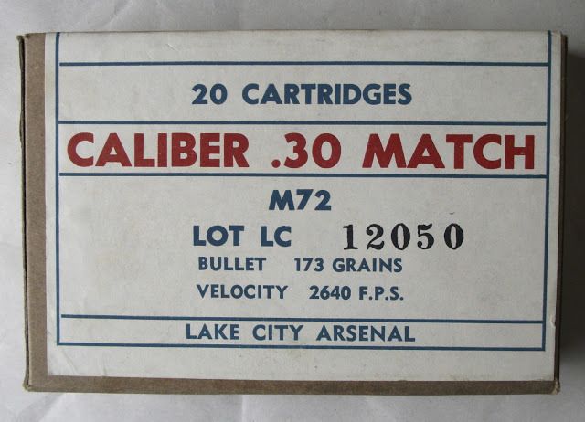

                    The carton shown (Lot LC 12050) was manufactured in 1961, 5 years before Carlos Hathcock was deployed to VN. Snipers were usually issued the best ammo available so he very likely used M72 MATCH manufactured in 1965 or later.

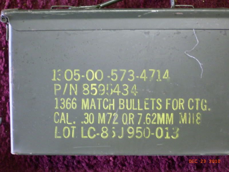

                          Standard issue M118 7.62mm match ammo used the same 173 grain bullet that 30 caliber M72 match ammo used. I have a couple of cans of M118 7.62 mm Match Ammo all loaded with the 173 grain M72 bullet. There were other varieties of 7.62 mm match ammo that used the 168 grain Sierra such as 7.62mm M852 Match . The issue of the 168 grain Sierra bullet being not for combat use was changed several times. I do not know what the final disposition was. I have boxes marked "NOT FOR COMBAT USE" and the cases were knurled about 1/2 inch above the extractor groove. As a matter of fact I have several cans of M72 bullets that are labeled for M72 and M118 use.

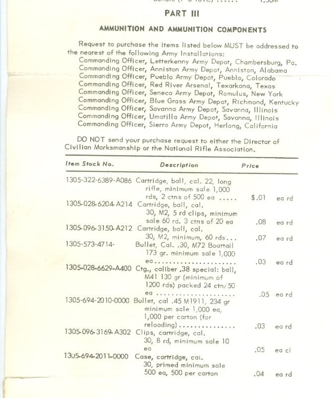

                          The DCM price list identifies the match bullet as the M72

                              From 1908 until 1919 the Match bullet was the standard 150 grain Ball M1906. Between 1920 and 1923 a 170 grain (both flat base and boattail) bullet was tested using the National Matches as a testing ground.
                              The 173 grain FMJ bullet was first loaded in NM ammunition in 1924. The cannelured version of the bullet was designated the M1 but the smooth (Match) version did not have any official designation. It was called the M1 Type. The M1 Type was used in the Cal .30 Match M72, the 7.62mm Match M118, and the 7.62mm M118 Special Ball which was a tactical round. The bullet was last used in 1994.

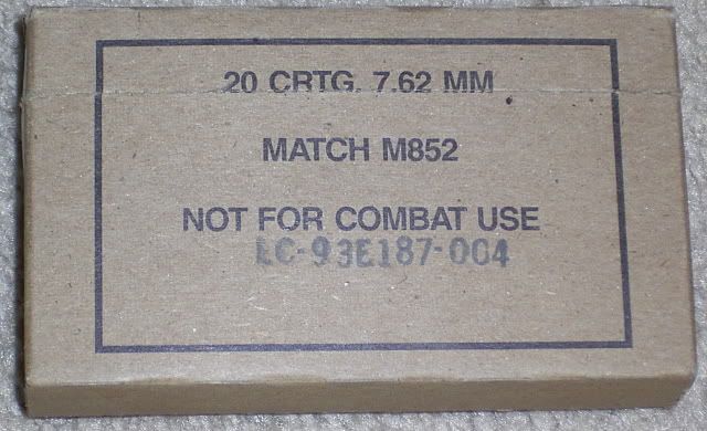

                              The 168 grain Sierra International (SMK) bullet was used in the 7.62mm Match M852 from 1981 until 1997. All cartons of M852 were labeled "Not For Combat Use" even though the JAG determined that it did not violate the terms of the Hague Declaration (not the Geneva Convention).
                              The 7.62mm Match M852 was the last NM manufactured by the US Military. The current 7.62mm M118 LR is a tactical round using the 175 grain SMK.
                              The so-called Mexican Match consisted of 7.62mm Match M118 with the bullet pulled and replaced by one of the commercial bullets, usually the 168 grain Sierra International (SMK). It was largely responsible for the decision to replace the Match M118 with Match M852 in 1981.
