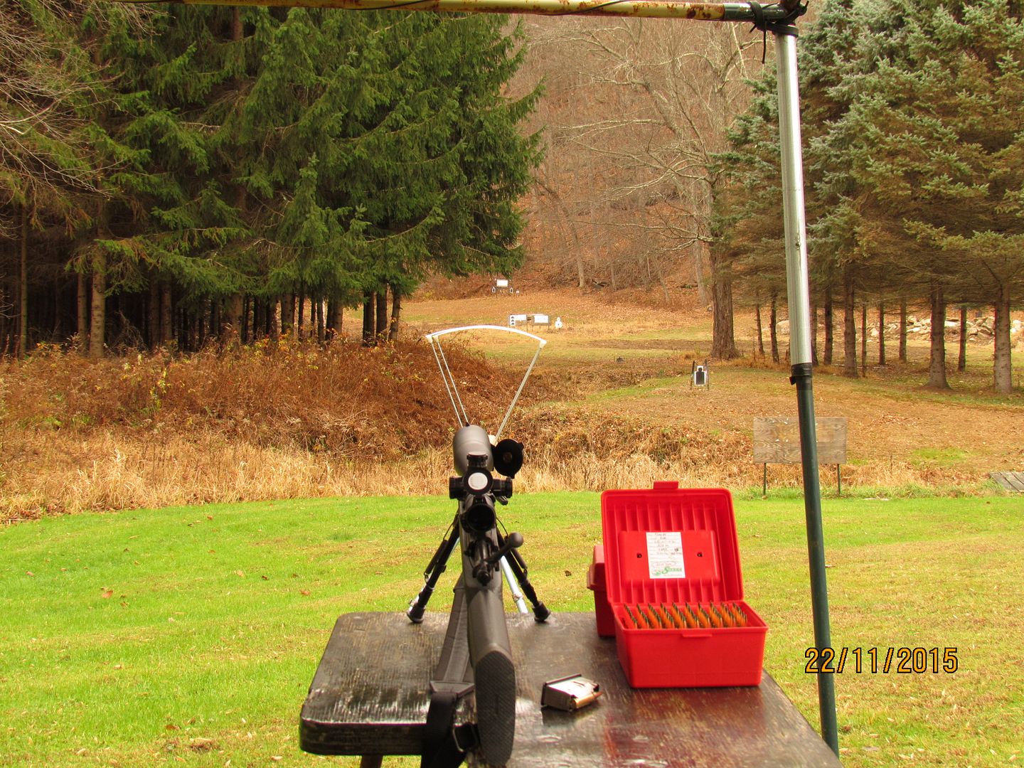

                      My Rem 700P in .308 with a Bell and Carlson with Leupold LRT 8.5 - 25 serves as my long range, all the way out to 300. Just joking. That is as far as I can shoot on my property and actually my range's normal distance is only to 200 with 100 and 150 getting the most use.
                      That is my favorite spotting scope, Car Zeiss 80MM using a Giraud stand. My wife kids that I should have been born a snake for the amount of time I spend in the prone shooting position. After 51 years of marriage, she has never let up once with the jokes.
                      Range is nothing fancy, but it serves me well and is only a hundred feet out my front door.
