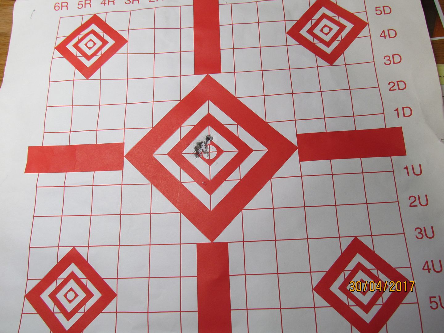

    Been working on new load for my Rem 700 this Spring. I think I found the key, at least for me shooting it at 100 yds.
    DAG brass trimmed to 2.05. Neck turned from .015 to .013.
    Tula Berdan primer using 40.5 gr of 4064 under a Berger 150 gr fb held .004 off the lands.
    Redding competition bushing die .001 under and Redding micrometer competition seating die. Bullets are running right at 2550 at 12'.
    Scope is Leupold MK 4 8.5 - 25.
    Ten round group at 100yds fired prone supported with bipod. Bag under butt. Intentionally left so as not to obstruct aim point.
    Max spread .6" Adverage .32"
    My best group in the past was a .44 adverage.
    That is an improvement of about 25% just by doing a little more work up on the load and a little more than standard brass prep.
    This was fired clean cold bore. Temp 59 deg. F.
    Semper Fi
    Art

      Applaud your load development. Always a joy to develop the loads that will bring out the best in a rifle. Sincerely. bruce.

          Sir, seriously, I think you need more 'stuff'. 8-)
          Decades ago, when I reloaded and fired for accuracy, I always shot 3 rounds to warm the barrel and get a little fouling in the bore. Now, I just reload normally and bang away.

            I have been a cold clean bore 1st rnd accuracy nut for 50 years. Used to be 1" was good enough. Now I keep setting new goals for myself. That .320 adv. is going to be hard for me to beat. It is tougher to get up from the prone position every year. So much more enjoyable just competing against myself. It helps to have my range less than 100' out the front door.

                  Nice to see good prep pay off.

                    Having way too much fun doing this stuff. I think a 25% improvement is worth every second invested.
