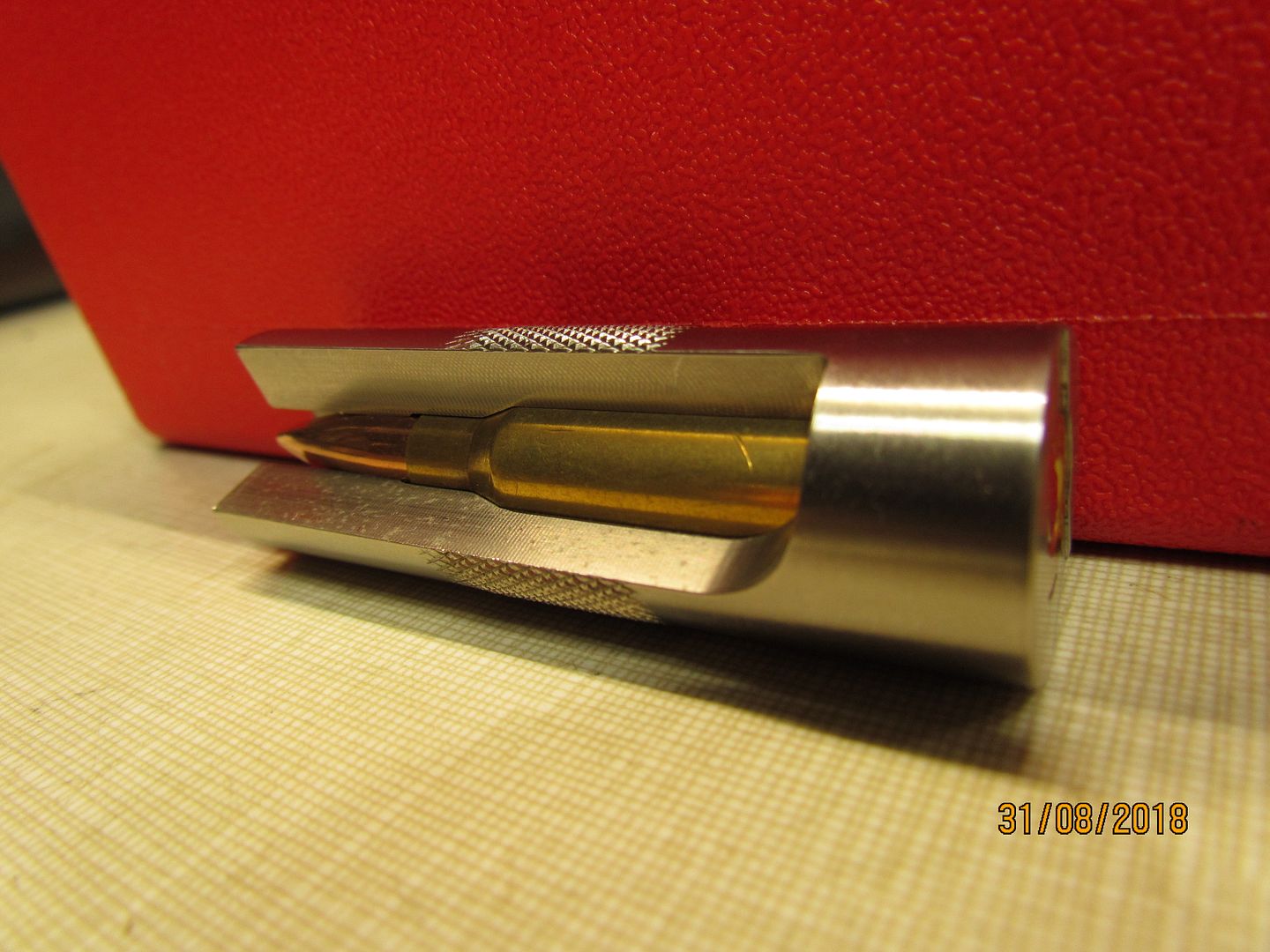

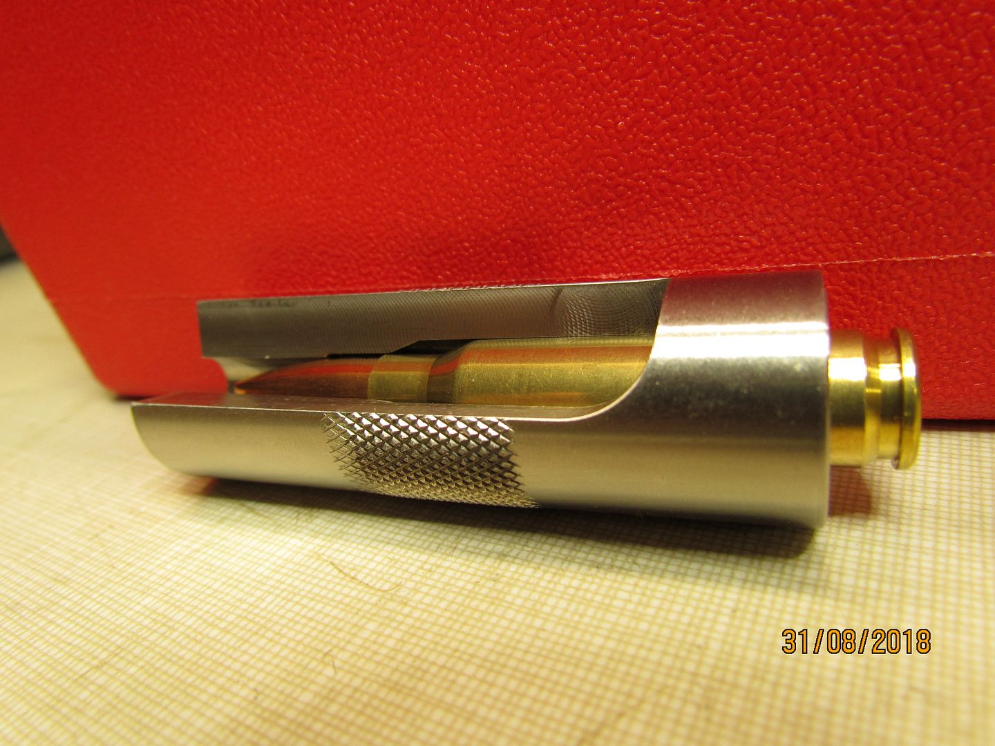

    The combination of FL dies and brass spring back in the area of the cartridge web can be detrimental to function when hand- loading. Difficulties chambering and in extraction both have been realized. Photos below show fairly good representation of this using a Sheridan cartridge guage to indicate correct and incorrect sizing. A properly sized cartridge should just drop in the guage and drop back out when the guage is inverted. The use of one of these guages for each caliber loaded can save a lot of grief encountered with poorly sized ammo. If your ammo fails with this check, chances are it will fail in your rifle.
    The use of a small base die when sizing tends to allow for this spring back and still keep the casing within usable SAMMI measurements and is highly recommended.
    First photo is FL sized and a no/go.
    Second photo is SB sized and a GO.

    The sizing requirement for handloads varies with the rifle(s) being used. For a modern commercial rifle w/ a chamber perhaps cut on the tight side of the SAAMI standard, a SB die especially in an semi-auto is useful. Loading for typical surplus military rifles, especial when the rifle is a semi-auto, a SB die is just about never required. With some calibers such as the .303 British, chambers are so large that a handloader is wise to size the brass to that large chamber simply to afford at least a few reloads for the cases before the brass fails. Sincerely. bruce.
      The main reason for this informational thread is to aleviate some confusion that exists when modern barrels with tight SAMMI chamber have been installed on M14 type rifles. A few have complained that" I have been using this same loading scheme for years and it worked in all my rifles". Another thing that has come up is " I use a Wilson headspace guage and all my ammo passes". Some re- loaders are not aware that the Wilson guage only checks headspace and not whether the cartridge will fit in a SAMMI cut chamber.
      Having experienced the same on some of my own rifles , it seemed a good idea to share the information and hopefully save others the pain of having to pull down loads and resize using SB dies as I have been doing for the last week or so for one of my precision rifles. This should eliminate the " my bolt rifle is really hard to chamber with hand loads , but commercial works fine". Spring back needs to be paid attention to.

                  1. Whether or not a FL die is set up correctly, there are times when more compression of the cartridge base is necessary to overcome spring back when the die is withdrawn.
                  2. Before this type of guage became readily available, we used to chamber a piece of barrel stock with the same reamer we used to to chamber the barrel being worked on. Been doing this for over 50 years so it ain't rocket science.
                  3. The cartridge web, of which I speak , extends up the base of the casing for some distance above the extractor grove and is where the base is comprised of the most material.
                  4. The majority of the custom barrels that I have been installing, on M14 type rifles for the last few years, indeed have tight match chambers, meaning diameter of the chamber is close to SAMMI .308 min., and generally require SB sizing be incorporated in the brass preparation.
                  5. The Wilson guages, in my shop, are used as a quick reference of cartridge headspace base to shoulder and overall casing length. The diameter of these is intentionally excessive for easy and quick measurements of length and not intended for checking diameter.
                  The split Sheridan cartridge guage is one of the most easily viewed methods of determining whether or not re-loaded ammunition will comfortably feed and extract from a rifle chamber. Plain and simple, they perform as advertised.

                          I don't know, but it looks like the 2nd pic swhows the cartridge below the rim, not flush. Excess headspace?Presentation3.jpg
                            Good eye PWC. I like to keep my brass short for use in my precision rifles and load the projectile out to a couple of thou from the lands. I have found , at least for me, I am able to get the lowest SD on the chrono this way.
