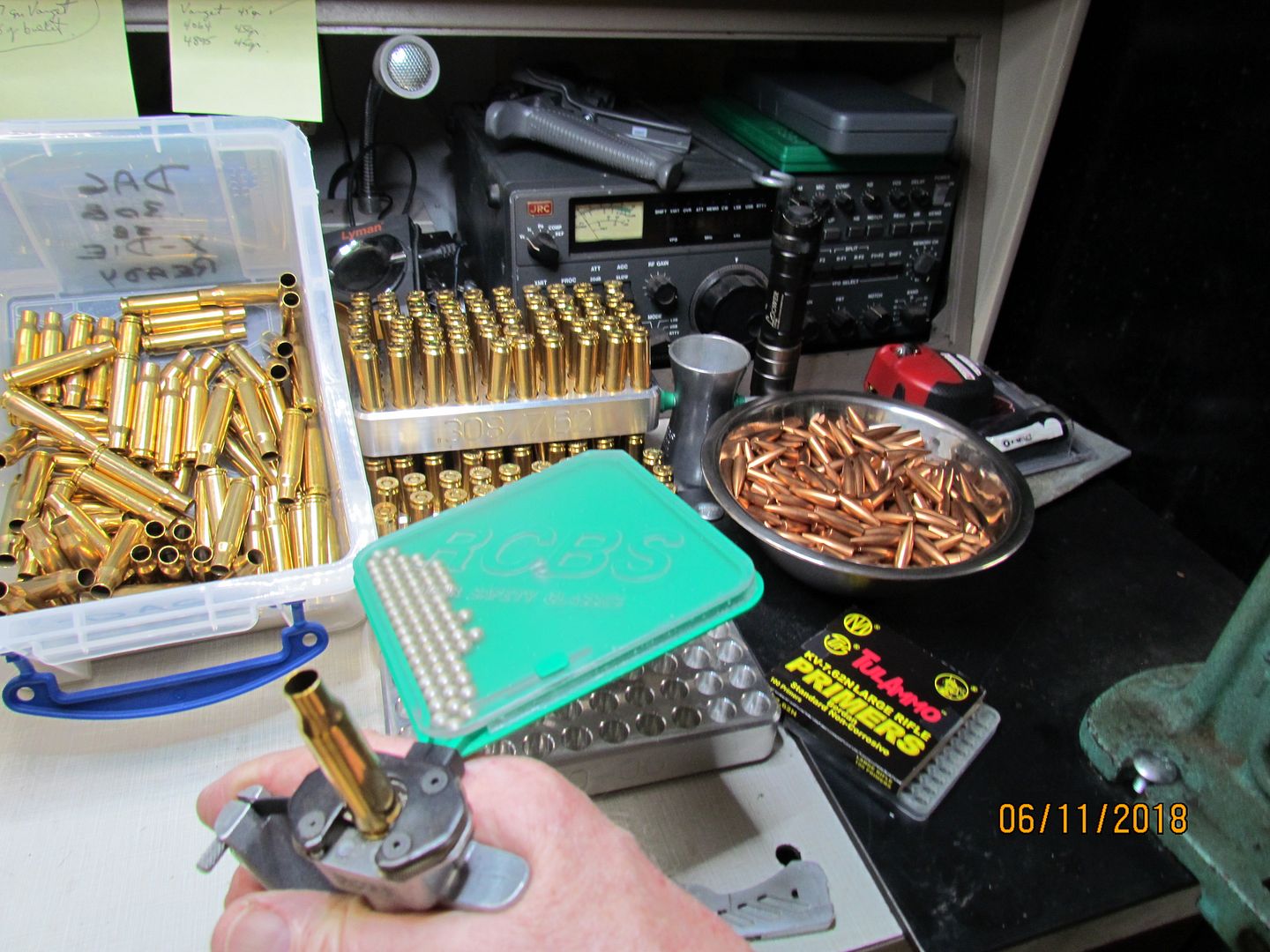

    Lousy day out today so I am running 3-100 rnd batches of ammo in DAG Berdan brass.
    Setting primers with hand primer is always fun.
    First hundred rnd batch was with Varget. Forgot to photo that one. Starting next batch with 4064 and then I will finish up with one using 4895 all using cusome 136 gr FB .308 bullets.

        How do you like the Tulammo primers? Never seen them before.
          They are great. Just can't find more. Berdan primers are hard to come by. I was fortunate in that I had 10k on the side when importing them was banned. Enough left for a time but sure would like to find another supply.
          I have found nothing better for precision rifle loading. Beats the crap out of any boxer brass primer combination I have found.
