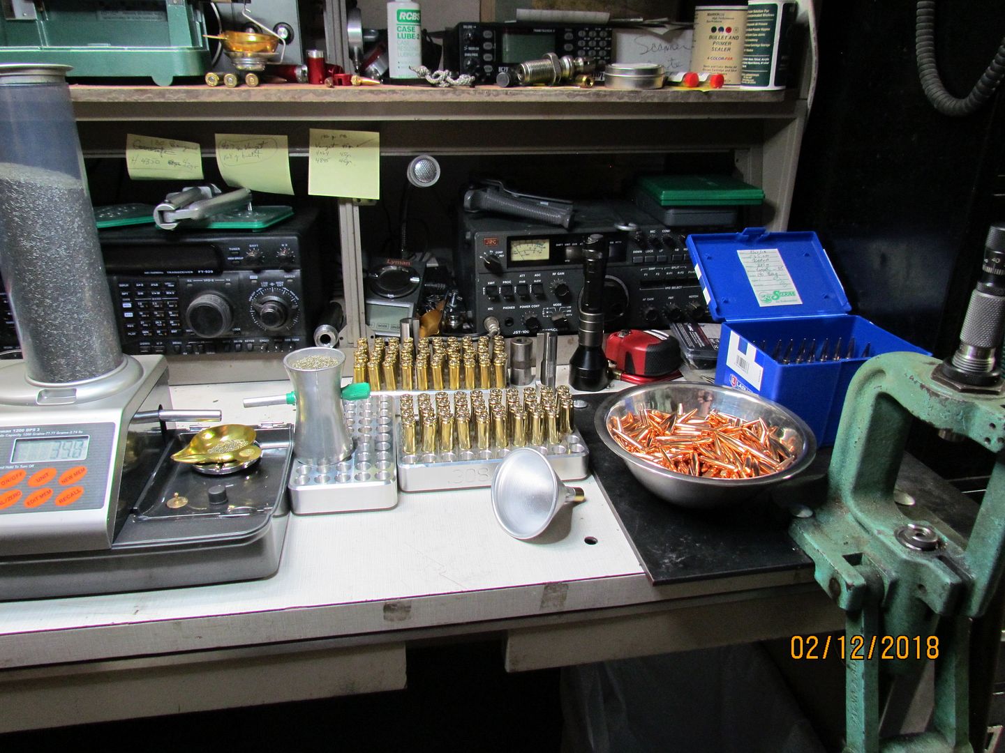

    I have seen recently a number of gents working up accuracy powder charges and thought I would add one of my procedures for getting my SD into the single digits and still using an autocharger.
    This would be used for precision loading to get the most out of your gear.

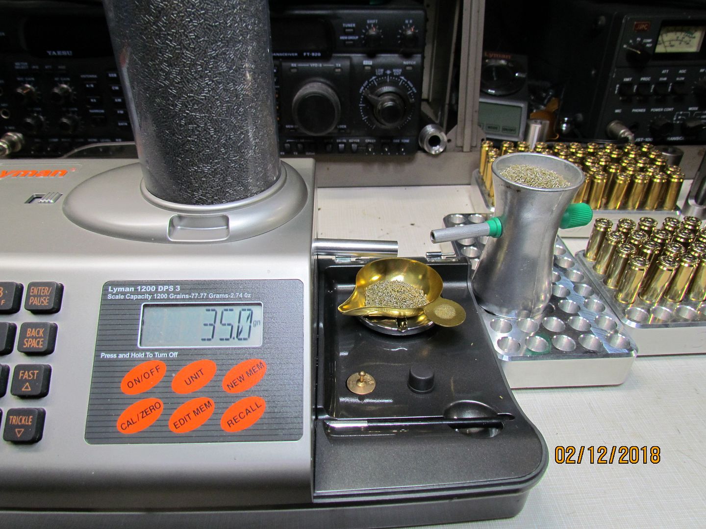

    I set the auto drop to a couple of .1s short of my destination load then hand trickle until the digit just stabilizes on the desired charge. This way I know my loads are consistent to within a kernel or two and my SD, if all else is equal, will be in the single digits.
    Works wonders over generic loading.
    Just ran a couple hundred 6.5 Creedmoor using Lapua brass, 205M primers and 35gr of Varget pushing a 140 gr Berger Hybrid Target bullet.
