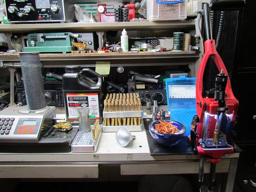

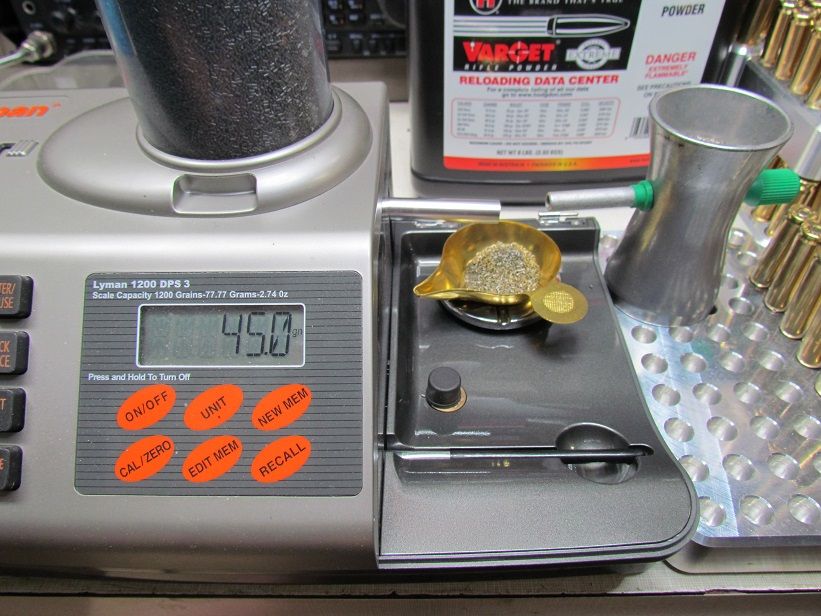

    Great day to work at the loading bench. Today's project is to fill a couple of 100 rnd range boxes with precision .308. DAG berdan cases, Tula berdan primers, 136 gr fb custom bullets over 45 gr of Varget. Supposed to be a great shooting weekend.

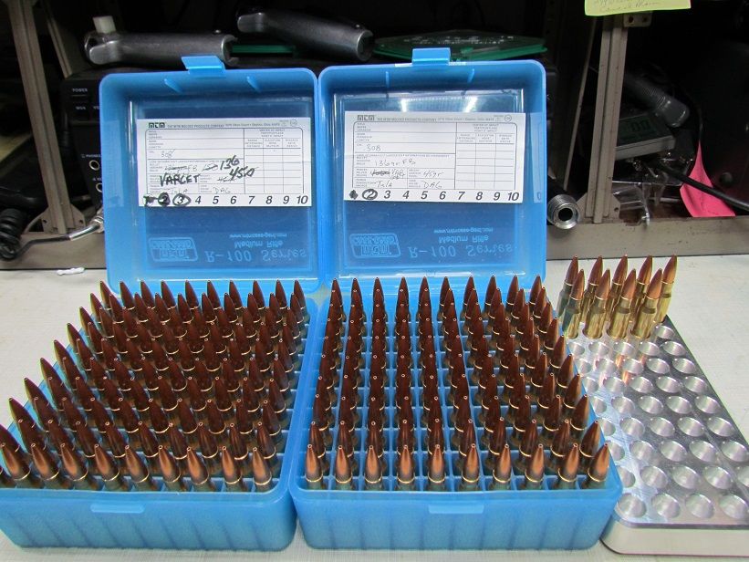

    Mission accomplished with a few spares to boot.

        they look too pretty to shoot.
