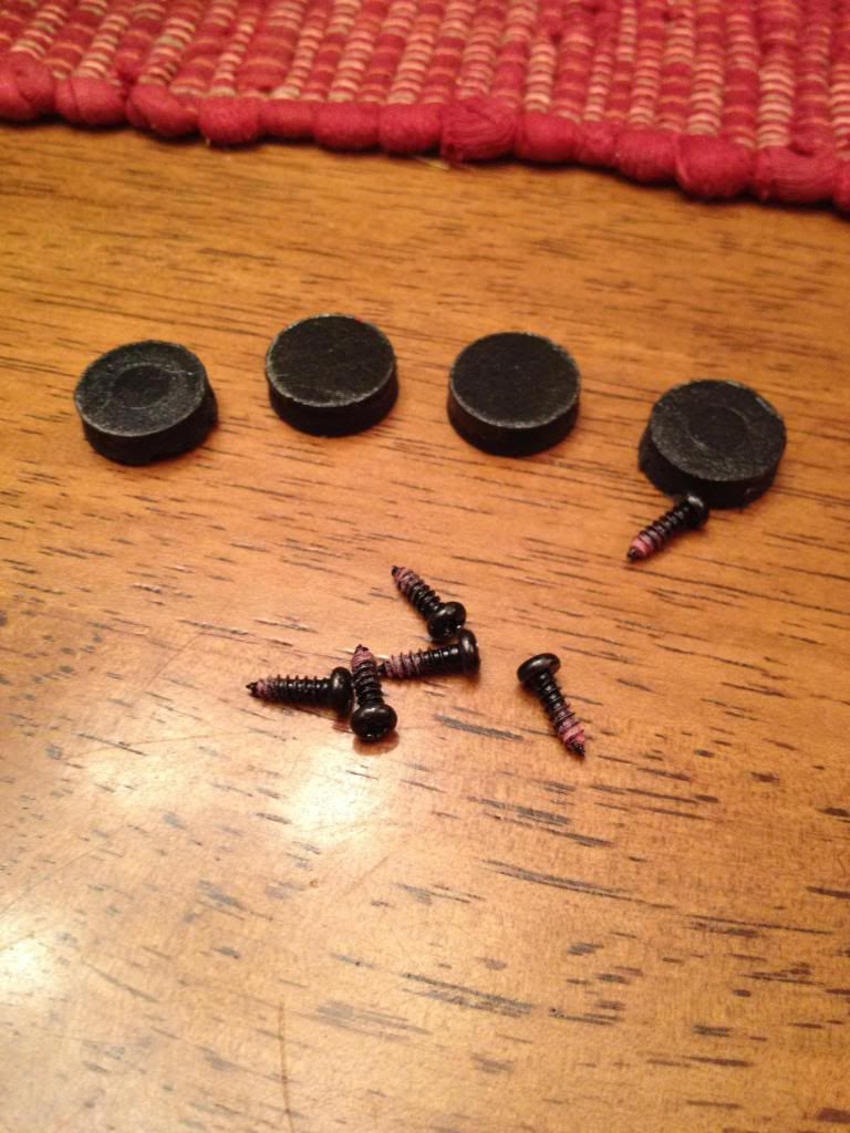

Essentially the entire bottom of the device can be separated from the top half. Start by removing the 4 rubberized feet. They are held in place with tacky adhesive and can be removed intact. You will need a small diameter shaft Philips screwdriver. The screws will be accessible when the feet are off.

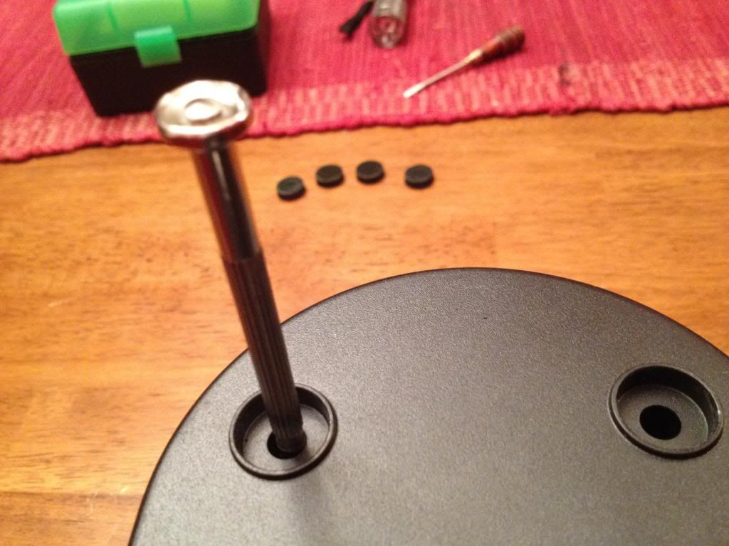

There are 6 identical screws. Two are already exposed.

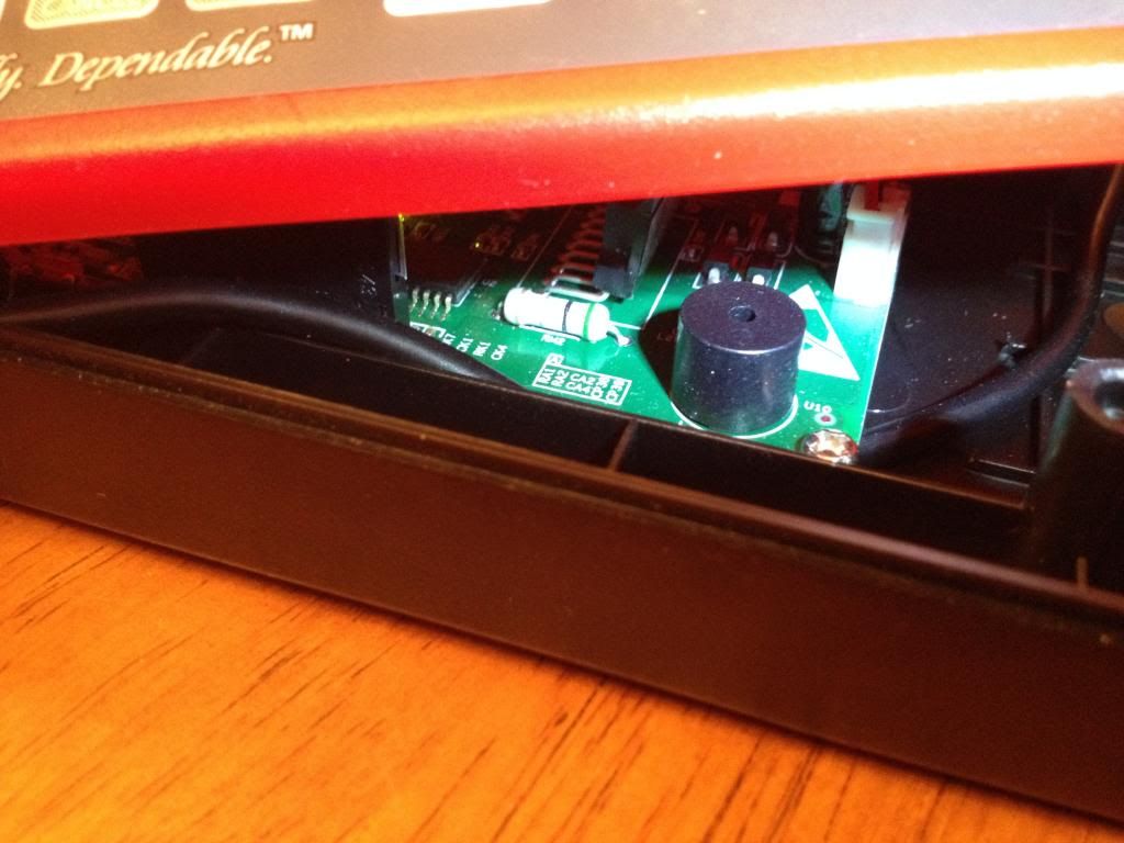

Gently pull the bottom away from the top half of the machine. You don't need to disconnect any of the cables inside that connect the screens and motor. At the front corner of the mother board you will see a cylindrical component as shown in the picture. A small piece of tape over the hole in the top will cut the volume in half. Reassemble in reverse order.

[/IMG]There are 6 identical screws. Two are already exposed.

[/IMG]Gently pull the bottom away from the top half of the machine. You don't need to disconnect any of the cables inside that connect the screens and motor. At the front corner of the mother board you will see a cylindrical component as shown in the picture. A small piece of tape over the hole in the top will cut the volume in half. Reassemble in reverse order.
