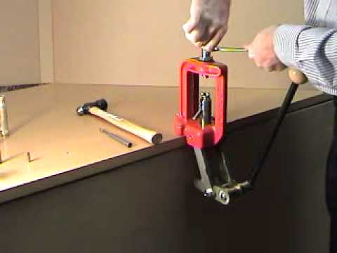

        The method described by joem is standard for conventional dies with threaded decapping rods, but isn't what is prescribed by Lee for their F.L. dies. Here's a video from their website showing how they do it - with no drilling and tapping needed.
        Stuck Case
        Posted by Steph @ Lee Precision on 04 December 2011 05:08 PM
        Tools required:
        Heavy hammer
        3/16" drift punch
        3/4" wrench
        1/2" wrench
        1) Leave the die in the press for this operation. Loosen, but do not remove the decapper clamp with a 3/4" wrench on the wrench flats on the die body, and a 1/2" wrench on the decapper clamp.
        2) Pound on the end of the 3/16" drift punch with a heavy hammer to release the stuck case.

          Yeah, I tried that... exactly as prescribed. Proceeded to bend (slightly) the decapper/mandrel. That case ain't goin no where! I've been told that Lee has fantastic customer service, and if I send it and the die is damaged or they can't extract the case, I'll get a new die in place of the old. Now I don't know if that's true or not... but I'm going to probably send it to them. I already talked to customer service, so they know the situation. We'll see...

                    I've used both methods many times over nearly 60 years of handloading - usually when experimenting with inadequate case lubes. Also bent a Lee decap rod or two doing it their way (no harm done and easily straightened). When in doubt, use the simplest approach first. If that doesn't work, try another.
