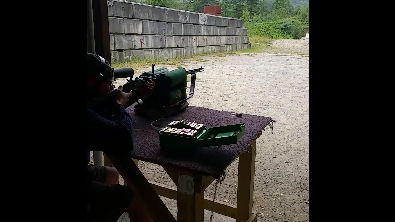

          Range report: First black powder.
          First, the video. Readers Digest version. If you care for a range report read beyond the link to video.
          This is "Black Powder first shots" by Sports Dad on Vimeo, the home for high quality videos and the people who love them.
          Range Report:
          5 rds of each 62 and 65 volume. (10 rds total)
          Observations:
          The "Smoke" wasn't impressive as I thought it would be but after reviewing the video I realized what everyone else was seeing. Very cool!
          62 gr of Dupont FFg were all over the place. 65 gr of same powder things improved!!
          I first had a great grouping of 65 so I'm confident 69-70 would be the best in the future, (of which 30 I've loaded this afternoon in 68-70 volume grs.
          Photo directly below is that of grouping (eek! not as accurate as Missouri Bullets in 405 with AA5744) and I'm still working the load. (bumping to 68-70 volume)
          All shots were with Notch's custom Titanium front sight replacement to hold the trapdoor on target at 100 yds. (This site is .350 from base of barrel to top. (Stock sight is .275)
          Grouping of 5 shots (1 test shot with 405) using 65 gr volume FFg and 500 grain bullet. Setting on the Buffington was set at 200 yrds. (Extra tall front sight allows for min buff mark of 200 to be used on 100 yd range thanks to the new front sights)
          I dropped each BP spent casing into a milk jug of warm water and dish soap for easier processing. I also ran a few Butter Bore patches down the barrel before I proceed to smokeless rounds. That first patch , bottom, came out awfully dirty. Normal for BP from my research.
