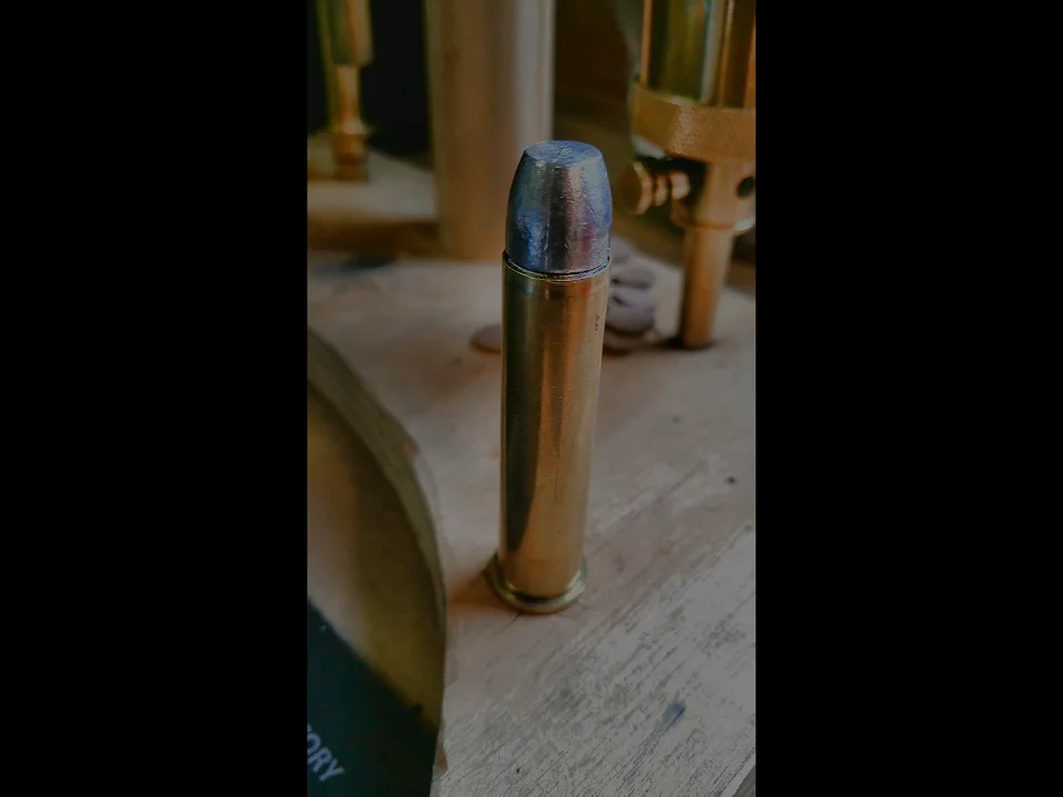

                  Short video. Hey, I was bored! And a friend asked for my reloading flow!
                  This is "45-70 405 gr BP reloading" by Sports Dad on Vimeo, the home for high quality videos and the people who love them.
