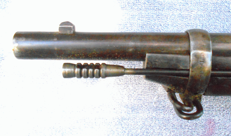

            I found this picture. Mine even has the relief for the cleaning rod. Never even noticed that before.

            • Dick Hosmer
              • 5997
