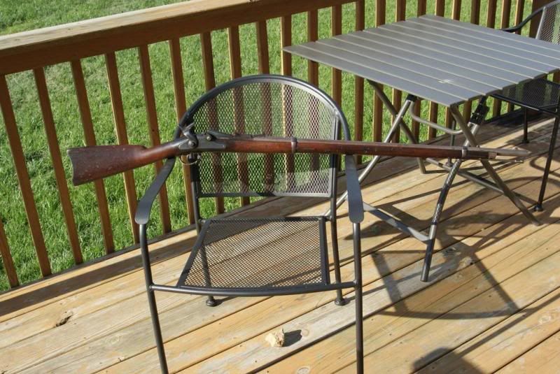

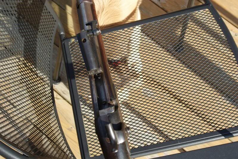

    First time posting to this site since it was revamped a few years ago.
    I recently came across someone who would like to sell what they described as an 1884 model Trapdoor which obviously isn't what they think it is. He just wants a few hundred dollars for it.
    It appears that this rifle may be what Richard Hosmer describes as an 1866 "Short Rifle" in his book "The .58 and .50 Caliber Rifles & Carbines of the Springfield Armory." I can find no reference to this model rifle in Waite & Ernst's book "Trapdoor Springfield."
    I have read that while Springfield Armory did apparently make a little over a thousand of these rifles, there is a lot of uncertainty as to whether or not they were ever issued. Some way that they were made-up and intended for sale to France for the Franco-Prussian war but the war ended before they were delivered.
    My real concern is that this may be a Bannerman rifle.
    The seller claims that there are no filled-in keeper spring slots on the stock between the upper and lower bands, and the pictures seem to prove that.
    Any opinions here as to whether or not this could be the "real deal" or is it an obviously Bannerman or other put-together rifle? Any questions I could ask the seller or additional pics I could have him take?
    Here are a bunch of pics:
    Thanks for any input.
  • Dick Hosmer
    • 5997

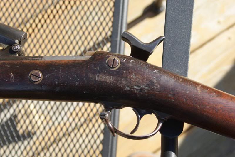

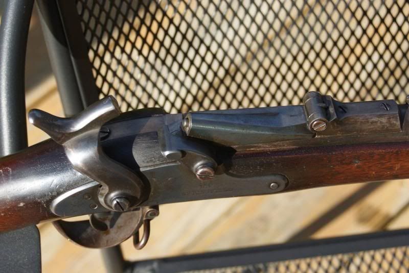

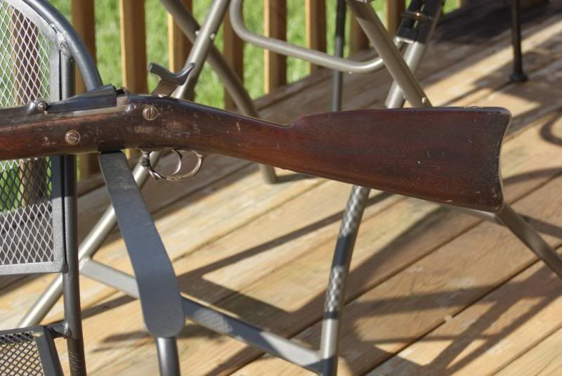

    It might be; though my first thought is Bannerman, even though there is (apparently) no filled middle band prep. The stock has been excessively sanded (and not recently) to remove the flats in the lock area, though the cartouches appear untouched. The rod should set back from the muzzle just like a normal 1866, but that could just be dirt in the hole/threads. This should be checked. Cannot tell if the rod has a stop shoulder or not (it shouldn't). Does the rod have threads on the end? It's not a bad-looking rifle at all, aside from the sanded stock. How much is a few hundred? If the rod/hole situation can be cleaned up to conform with my book, it might be worth it. Due to the stock sanding, it will never be totally correct, but they are scarce. What is overall length?

          As for the musket being discussed I have been led to believe these are Bannerman guns which often have the wrist area thinned down . I have seen several muskets like this one that have had the flats removed while leaving the cartouches!

                Thanks for the responses. Seller says that the cleaning rod has a threaded end. Overall length is 52".
                • Dick Hosmer
                  • 5997

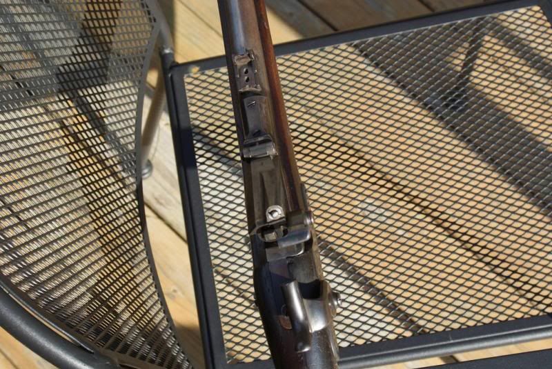

                  Well, the 52" is correct, and, FWIW, the front end looks correct as far as I can tell from the one relevant pic. Next test is to clean the rod-hole, and see if the rod will screw in and seat at or near the proper 1-1/8" setback from the muzzle. If that all works, I'd say it at least could be a legitimate short '66, albeit one with an unfortunately (though nicely done) rounded stock. All in all, it's a good-looking piece - I'm a bit disturbed by the obvious variance in finishes, but bright daylight is NEVER kind to our treasures, and if properly displayed, that one would look very nice indeed, even more so if the price is modest! :-)
