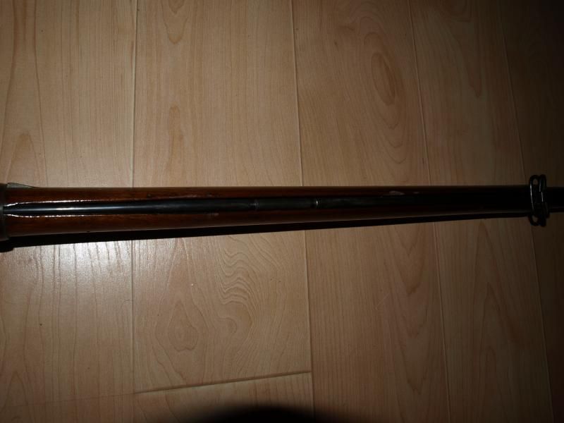

            The wood is definitely not tight around the bayonet not sure I would call it hogged out but will definitely get pics tonight. The bayonet catch is definitely the 1888 style and not the flatter straight one of the 84XRB

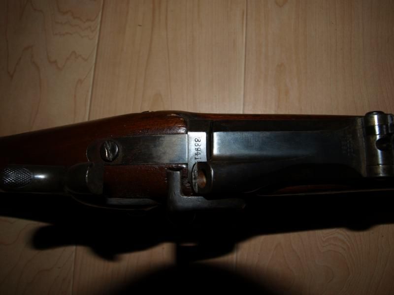

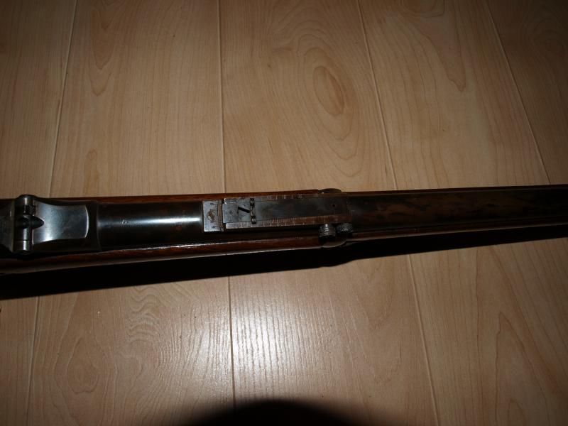

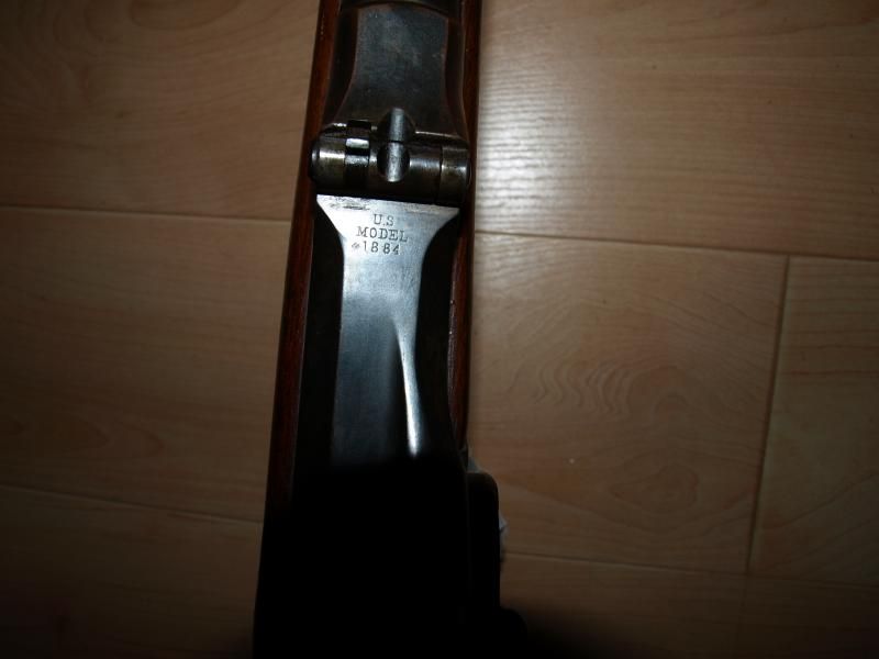

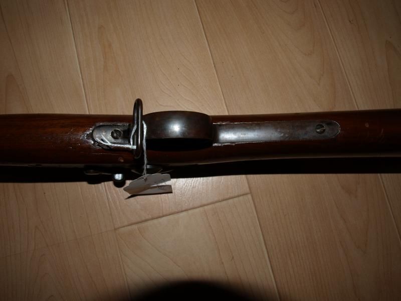

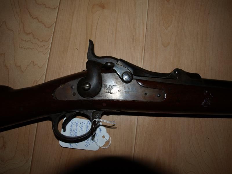

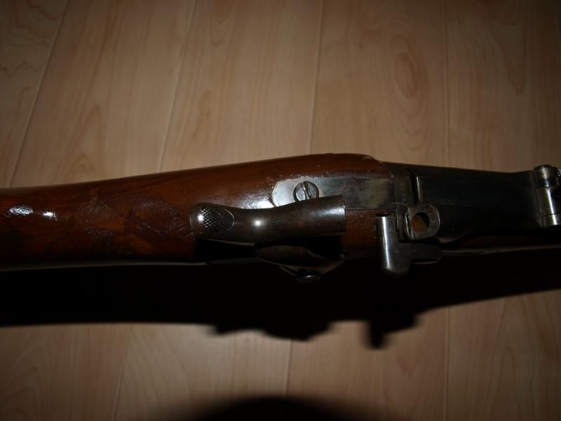

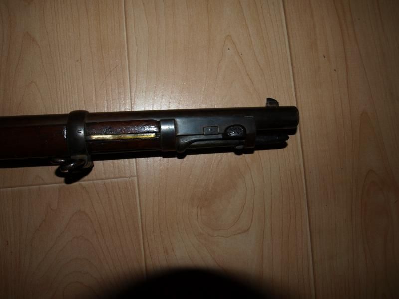

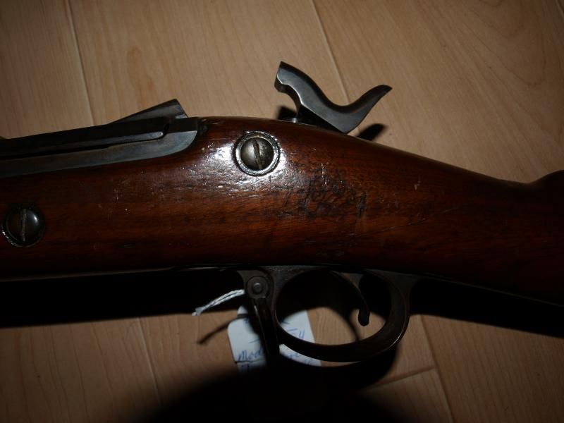

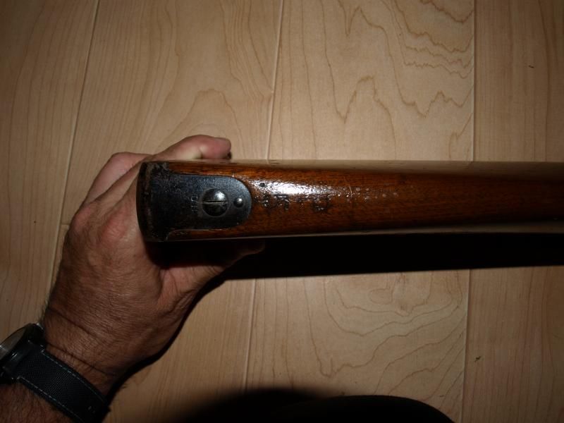

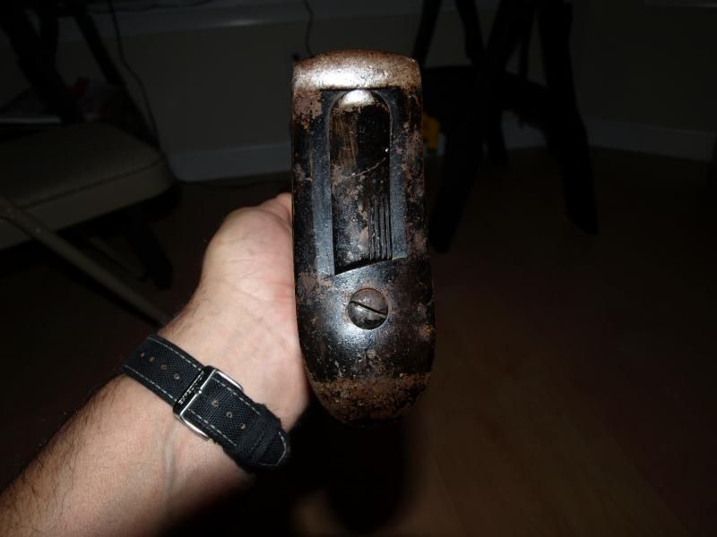

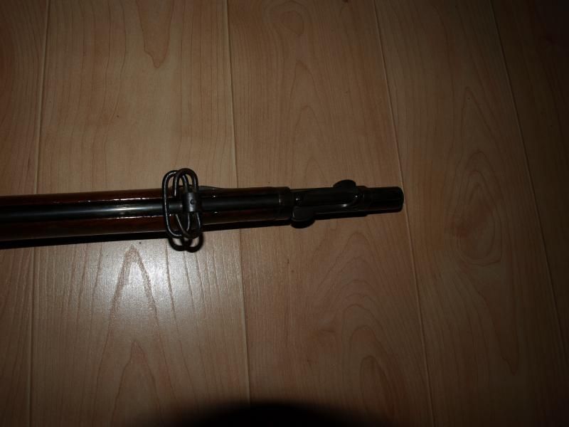

              Ok don't hate me seems I was mistaken on a few details as my poor tired eyes are not as good as the computer pictures show. The SN is actually 339414 Also the date on the stock looks more like 1887 or possibly 1884? Hard to tell... here are the pics....
              • bbarer
                • Jul 2014
                • 6
                Here are a few more..
                • Dick Hosmer
                  • 5997
                  I cannot explain your rifle, beyond saying that it must be the result of an overhaul (probably a perfectly legit one - rifle does not appear to be a bubba) at some point in time.
                  Aside from the serial number it is pure typical late M1888, right down to the slightly taller almost 'spidery' type font on the lockplate. The rod inletting is the wide variety. I shouldn't do this, but here is a pic from my new book. Note the numerous differences between the 84XRRB (318991) on the left, and the normal "1888" (527686) on the right. Almost nothing is the same.
