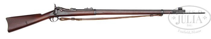

            • 5MadFarmers
              • 2815
              Julia sold 157186 for $3,162 in the Spring of 2013.
              • Dick Hosmer
                • 5997
                That's a VERY nice one, at least as good as the one at Collectors - and definitely better than mine. Interesting that Julia felt it necessary to spin the s/n as a possible anagram of the one on Al's list - totally superfluous BS, and probably a wrong assumption to boot. It's in the right range, what more need be said? Sad that the market has fallen so much - many of the rare items in the Branum collection, for example, went far too low last year at Cowan's, IMHO.

                • 5MadFarmers
                  • 2815
                  That's a VERY nice one, at least as good as the one at Collectors - and definitely better than mine. Interesting that Julia felt it necessary to spin the s/n as a possible anagram of the one on Al's list - totally superfluous BS, and probably a wrong assumption to boot it's in the right range, what more need be said?
                  When faced with a list of what are unusual guns, and the one that you're looking at isn't on it, suspecting a transposition isn't too strange I guess. 157186 vs 157816. Two numbers transposed. It caught my eye and I watched it go. I was mildly interested but not $3K+ interested as I paid less for 157816. So the number transposition would have been amusing to have but not amusing enough to pay that market.
                  Ebb and flow of the market and finance. Not a bad thing if you're buying but obvious not good if your selling. I'm not really doing either right now so no big deal. I did dump some more modern stuff and some ammo and that was selling like hotcakes.
                  Joe, do I have the numbers on all three of yours?
                  Thought you had them. 156793, 156831, and 157816. That last not being a typo.
                  What a gun is worth is what it'll get on the open market. If it doesn't get it, it wasn't worth that. If it does, it was. The market changes over time so only a sale will determine what anything is worth in that market at that time.
                  FWIW I bought the three in a four month span five years ago. Averaged to $2,100 per rifle. I wanted one so the gun gods smiled once again and three found me. Hard to turn strays away. 157816 came with the batch which included the BoOaF Krag. That was a nice batch.
