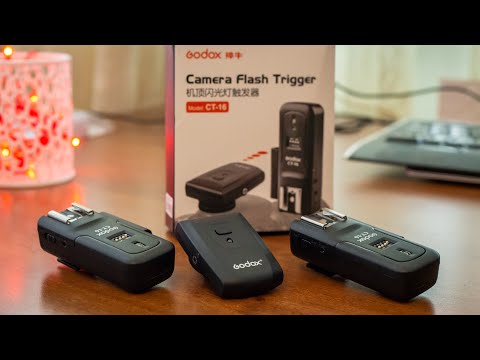

    I finally gave up on optical "Slave Flash" triggers & am looking into radio units as an upgrade.
    Looking for user experience.
    I have basic requirements, no dedication, No TTL just Hot shoe.
    Equipment
    Cameras
    Fuji Finepix S 7000
    Fuji Finepix S 9100
    Lights
    Sunpak 622 auto
    (5v trigger)
    Sunpak 611 auto
    (180v trigger via Wein safe Sync so 5v)
    Vivitar285HV (new version)
    (6v trigger)
    Sunpak auto super 383
    (6v trigger)
    Vivitar 5600
    (6v trigger)
    I'm looking for the ability to use up to 4 Units for mini home studio purposes. Maximum distances will be probably 50' so real long range is not a particular benefit
    Any reviews, based on actual experience preferably.
    Good & bad points please totally uncommitted at this point, but the "GoDox CT16" with 4 receivers seems to be leading the pack. Any experiences with that exact model?

          Thanks. you may have made up my mind for me! The vello freewave fusion uses ALL "AAA" batteries. Both receiver & transmitter. The "GoDox CT16" with 4 receivers uses "AAA" for the receivers, but a 12V 23A lithium battery (Not included) for the transmitter.
          I've never seen such a battery locally.

                        The "New" radio triggers arrived, finally.
                        Yay they work!
                        The red lights indicate a signal received from the transmitter, initiated by firing the camera shutter.
                        It also confirms Sync.
