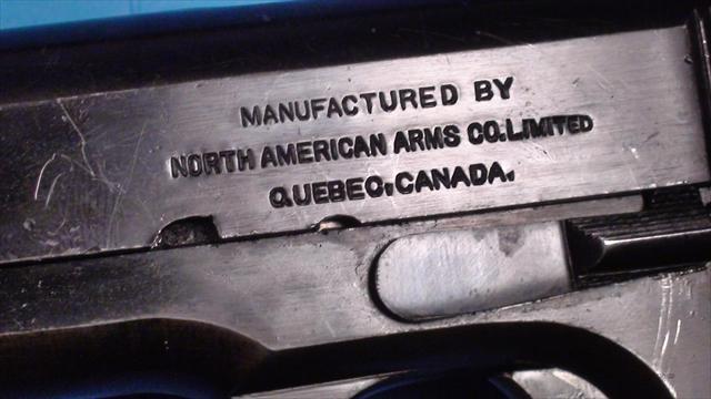

    Here is the NAA slide address on #77
    Here is the serrated slide stop on #77
    Here is the slide serial number on #77
    Here is the slide serial number on #87
    Here is the slide serial number on #5
    Here is the NAA slide address and serrated slide stop on #63

          The photos seem to bear out that all the original pistols have serifed serial numbers on the slide, with the same style serifed number on the trigger.

                              So number "5" is the only example that has been shown that doesn't have a serified serial number. It also has a checkered slide stop where all the others seem to be serrated. Is this because it is very early in production or ?
                              • Scott Gahimer
                                • 899
                                #45
                                No. 5 also has a checkered hammer with a different profile than any other known NAA pistols I am aware of. Most NAA hammers are smooth (no knurling at all). #87 has some checkering, a similar profile to #77...but is still machined differently. The hammers in numbers 77 and 78 are identical. They are both smooth and have exactly the same contours. NAA #80 at the recent Morphy auction was interesting. Like a few other known NAA pistols, the slide stop on it was void of serrations. They just didn't get machined into some of the pieces.
