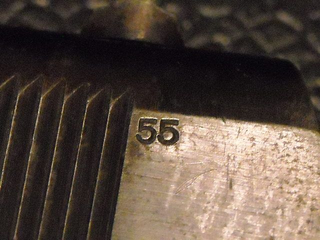

      Originally posted by KeithNyst
      Here's link to a pic of #55 that oldcanuck uploaded on a different site. Haven't seen posts from him for awhile; hope he's ok.
      I'm OK...but unfortunately my wife isn't. Here is a close up of the slide SN on 55. BTW the slide stop is serrated and the hammer is smooth on this example.
