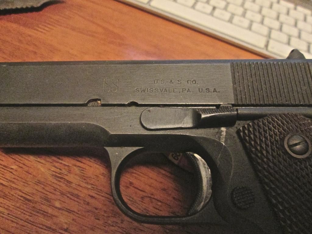

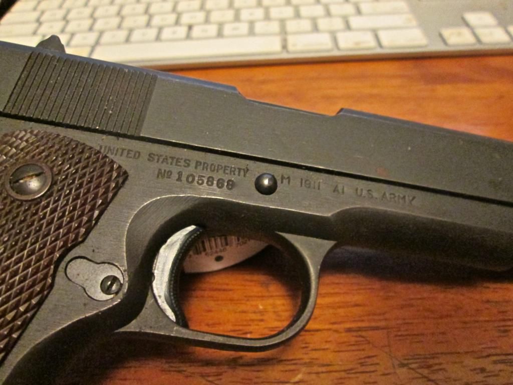

    If the buyer knows who he bought it from, he should seek redress on a pistol that is illegal to possess, much less sell. While the serial number is a US&S number, it is not original to that receiver.
    The really troubling part of the pistol is that the markings were applied with a roll die rather than the engraved or pantographed markings were are use to seeing. While not illegal, it certainly isn't ethical to apply manufacturers markings to a pistol that never had them, but the serial number is another matter. The set up to do roll markings isn't something you find in every gun shop, as this is a rather sophisticated operation to apply them. While the circle/RCD and the serial number were laughable in their crudeness, the roll markings are certainly much better than anything I have seen to date.

            I am more inclined to believe the pistol is home grown. It is a far step ahead of some of the crude fakes we have seen, but still has too many details that are not correct. As we can see it fooled at least one buyer, but an experienced collector would have picked up on the problems immediately.

              The receiver is an Argentine that was imported, provided it is forged and not cast. In many cases, one who fakes such pistols does not remove the interior serial number on the back of the receiver, under the MSH. Perhaps they think leaving one serial number clears them of breaking the law, but it doesn't.
              The dimensions of the recoil spring housing (dust cover), visible receiver around the stocks and squared off profiles are the dead give-away to the Argentinean pistols. They're dirt cheap, easy to acquire and end up being used to fake all kinds of more expensive pistols...including Singers. Every visible marking I was wasn't right, nor was remotely convincing...but too many people just read the markings and miss the characteristics that truly identify manufacture.

                    In your discussions with Marc at Keystone Arms, did you confirm that the receiver is an Argentine?
                    I initially though it was most likely Argentine. But, the finger cutouts and the mag well thwarted that conclusion.
