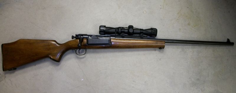

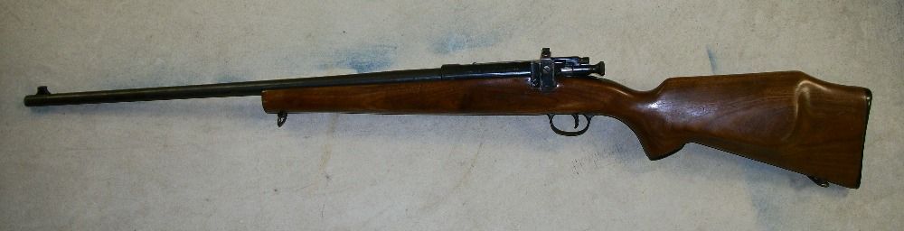

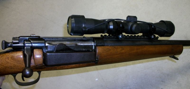

    I mounted a long eye relief scope on my sporter to use in cast bullet matches using the Kraghaus mount. Today I hit the range and got it sighted in at 100 yards. Shooting 185 grain spitzers that Madsenshooter cast for me, I put 25 on the paper with great results. The lower shots were while sighting it in, and I pulled a couple... but I have at least 14 shots in a 2 inch group around the bull! Woohoo!
    I have included a picture of my sporter, a close up of the mounted scope, and my target.

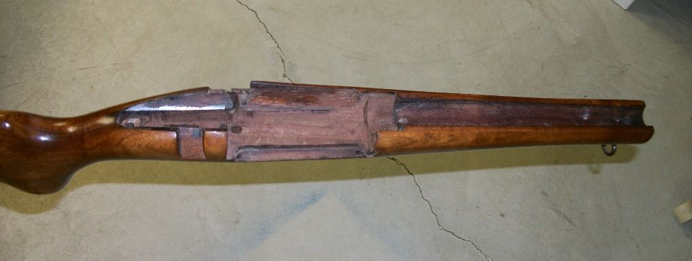

              Is the sporter stock attached anywhere else to the barrel/action other than the two trigger guard screws?
              • psteinmayer
                • Sep 2011
                • 1527
                Nope, just the trigger guard screws... so it's totally floating. The stock is pretty beefy, so I'm not really concerned with it cracking, but I hate the stock anyway. the only thing preventing me from replacing it with a better stock is because I can't afford a new one!

                  Ok. The sporter stock I have is very beefy also, so I'm thinking about just using it for now until I find a replacement. Can you post another picture sometime of the left side of yours. Thanks.
                  • 13Echo
                    • 162
                    The Krag is secured at the rear of the action by the trigger guard screws with no front action screw and is secured at the front by the barrel band. Unless someone added a front action screw or front band or screw your rifle isn't well secured in the stock.

                        Smokechaser, here are a couple pictures: The left side as it was before I removed the Redfield 102K rear sight, and the stock itself, so you can see how it beds. The work done fitting the stock is actually pretty good, but there is a crack in the area where the receiver side plate is because the wood is quite thin there. It's not in an area that affects the strength of the stock though.

                          I shot in a Cast Bullet Match yesterday at Washtenaw Sportsman's Club in Michigan with my cutdown 1898 sporter. As you can see from the pictures, I have a 7x32 scout scope mounted with a Kraghaus barrel mount. I was shooting 185 grain spitzers that Bob (Madsenshooter) cast for me. Not too shabby! I scored a 179 6X at 100 yards and a 178 1X at 200 yards (both out of a possible 200). The targets that they gave me to use were 25 yard pistol targets and the black (9 ring) were only 5 1/2 inches across. At 200 yards, that is an incredibly small target! The few pulls I had were more me than the gun... This ole coot is not as steady as he used to be, LOL
