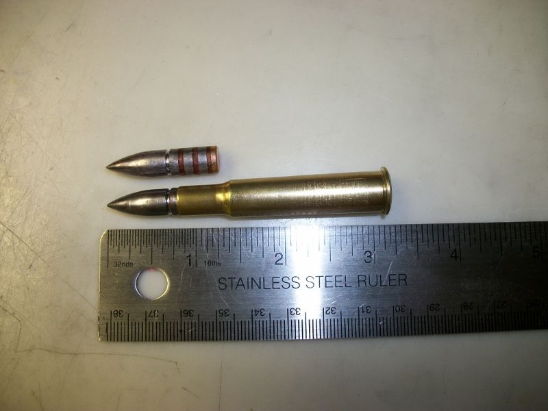

To be honest, I'm loading my rounds with 19 grains of Accurate 5744 and a CCI standard 200 primer. My OAL is 3.14. I'm only pushing around 1600 FPS in these!
Here's a picture of one of my loads, along with a bullet.
"I was home... What happened? What the Hell Happened?" - MM1 Jacob Holman, USS San PabloComment
However, the bullet retains a fair degree of accuracy up to at least 2150fps, about as fast as you're safely going to get one going out of a Krag. You need to understand, these aren't cast of WW or waste alloy. I wouldn't attempt over 2000fps with anything less than linotype. I am using a copper toughened alloy in my post about duplicating the 1907 Palma round, I had to keep the percentage of Pb high to get the weight I needed. Otherwise, I'd be using the same alloy I cast Paul's bullets of, and they'd weigh around 190gr. Paul's just starting, he hasn't had time to work up the ladder and find the accuracy hotspot.Last edited by madsenshooter; 06-21-2014, 10:01."I have sworn upon the Altar of God, eternity hostility upon all forms of tyranny over the minds of man." - Thomas JeffersonComment
