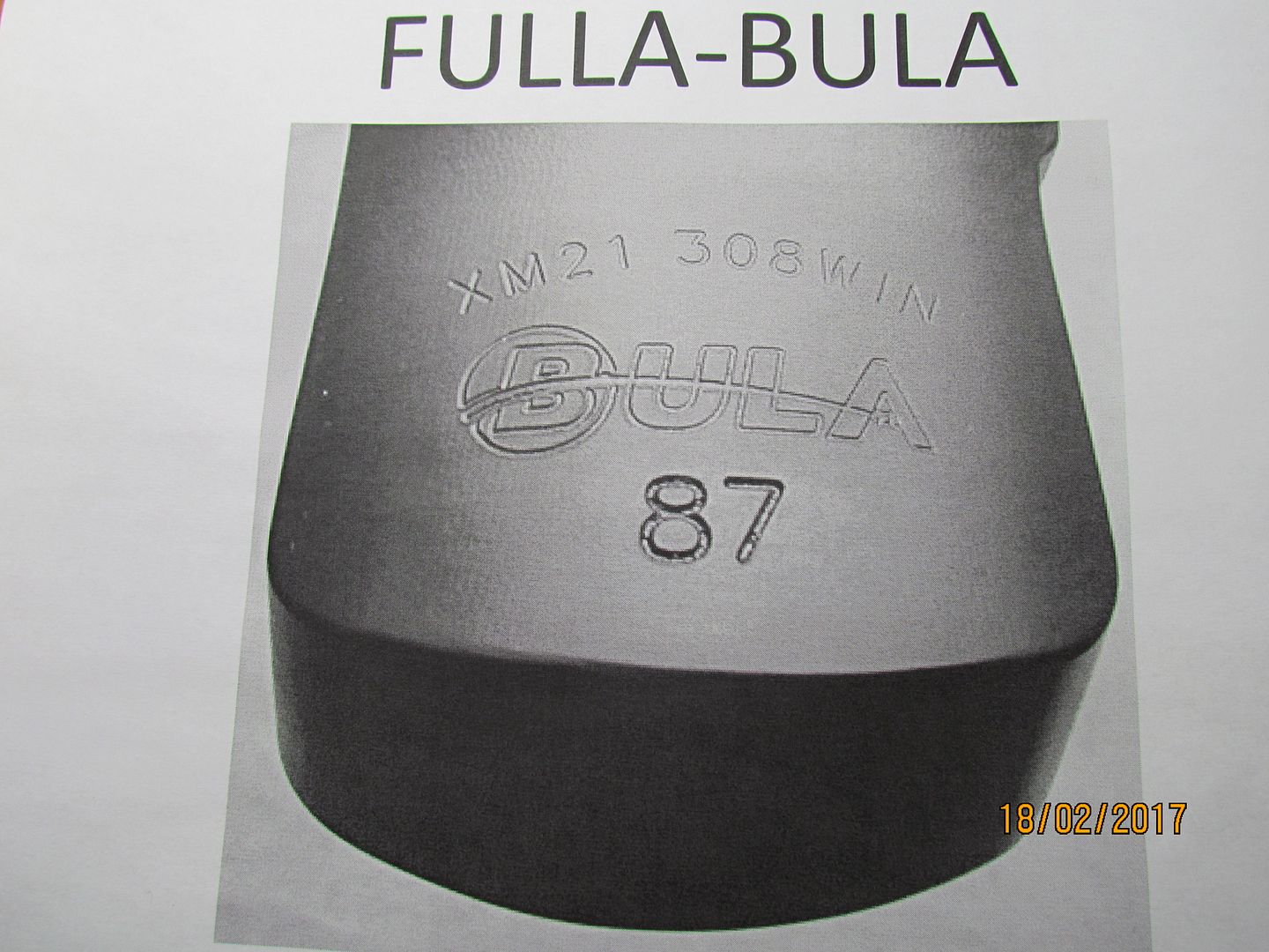

    Bula Defense Systems XM21 87

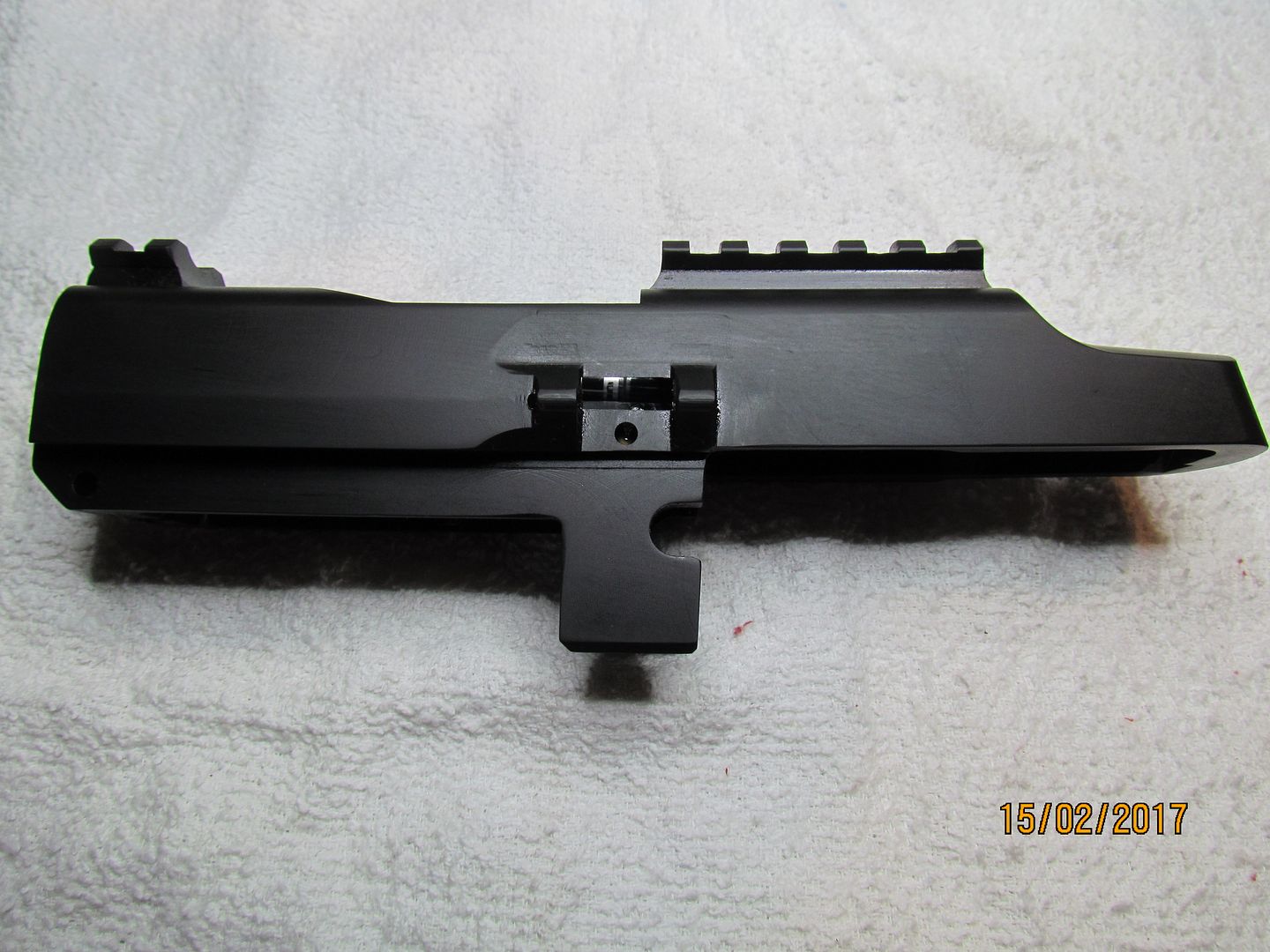

    Receiver just came in today for another project.
    XM21 will be fitted with a Wolfe 18.5" Fluted chrome lined barrel.
    Majority of small parts will be Bula.
    Stock is walnut USGI which I finished over the last few months.
    Can't wait to get started. Maybe this weekend.

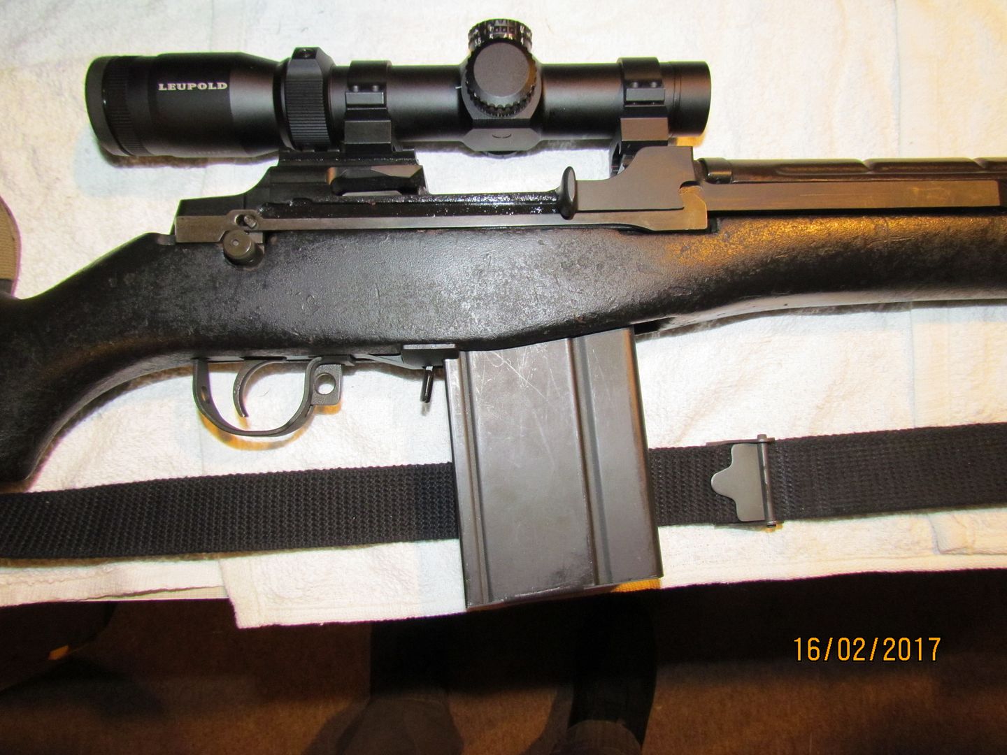

      Am I seeing things? Is that a selector knob on the receiver up above the trigger? Now. When can you build me one?
        • 2149
        Sorry Randy, that is just one of Sparrowhawk's faux kits. It attaches to the stock and not the receiver. Looks pretty authentic though. Made with all USGI parts. I use them to fill the hole in the stock.

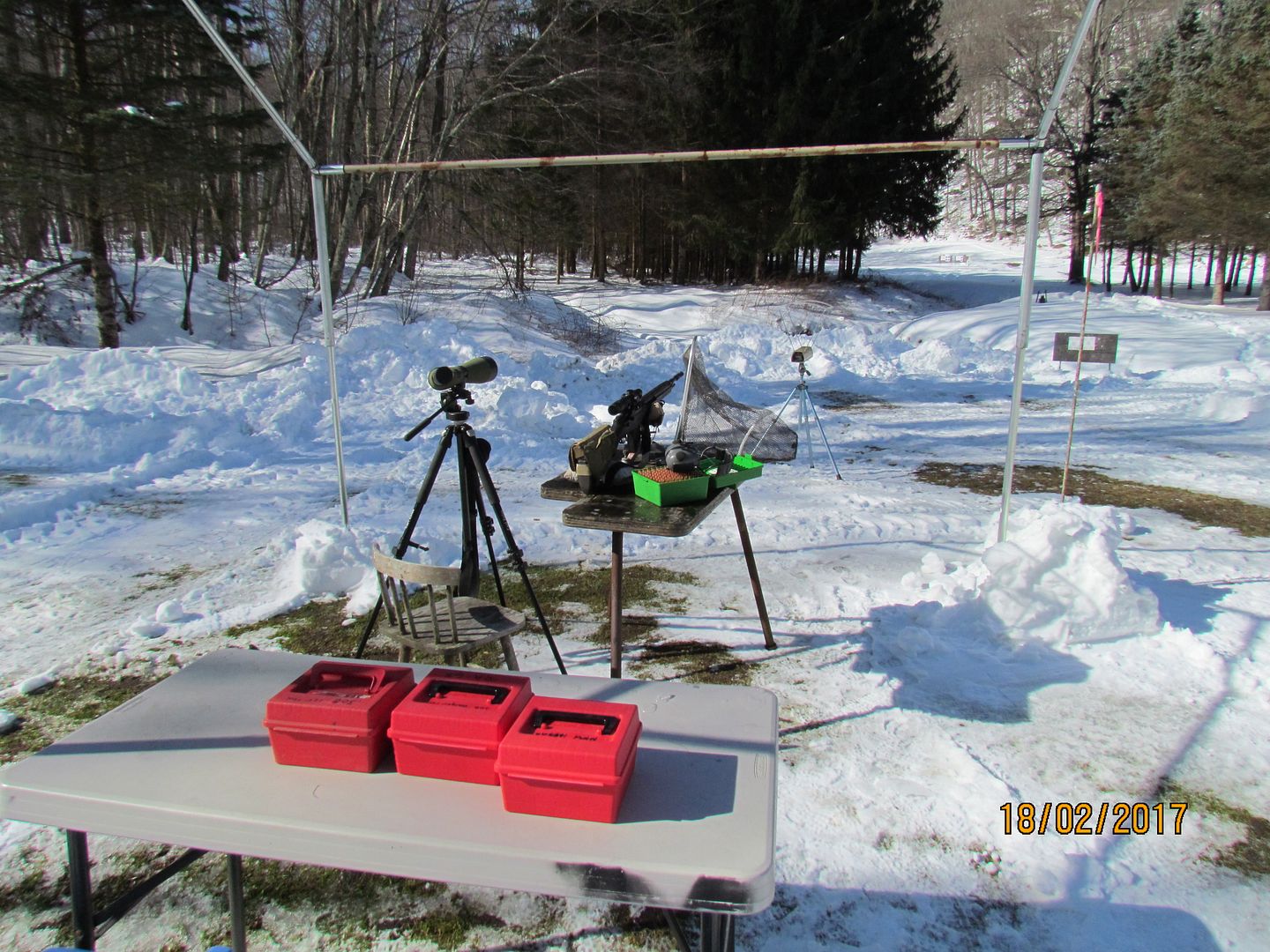

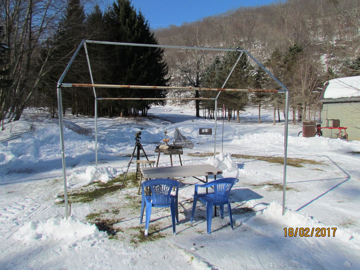

              Getting ready to test accuracy on #87. With 8 - 12" of snow left on the ground and a crust on top of that , it took awhile to clear things around my shooting position. Took the loader out on the range to make some tracks for walking in.
              Ready for a nap and its only 10:15 am.
              Semper Fi
              Art
                • 2149
                Got out and ran 87 through her paces. Found that I am going to have to load specifically for this shorter barrel. Dropped 200 fps over a 22". Not a real problem, but an observation.

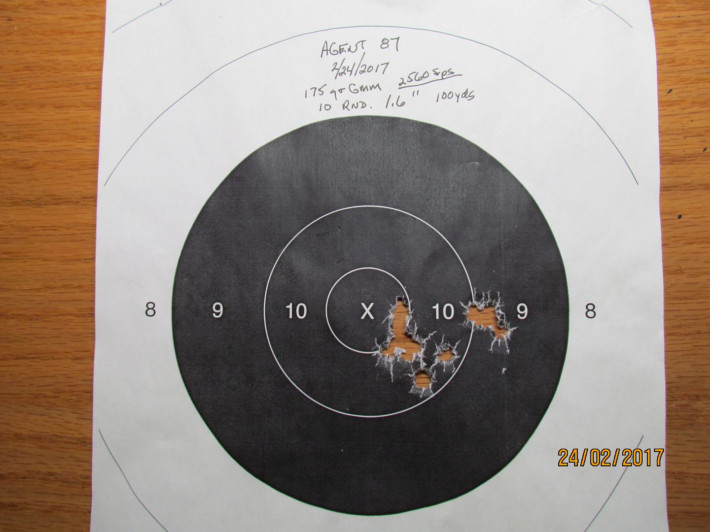

                        • 2149

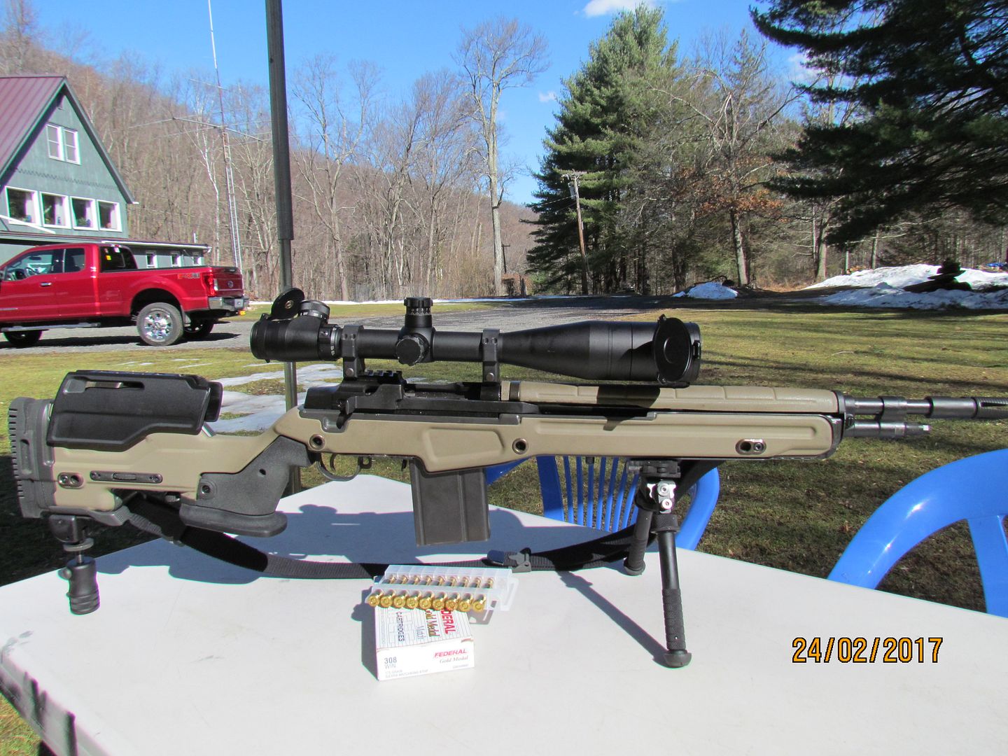

                        Progress in accuracy. Agent 87 seems to prefer 175 gr Federal GMM over all other fodders tried to this point. Just to eliminate other variables she is resting in a JAE Gen III stock and is quite happy. Today's weather prompted me to get out and get er done. Managed a 1.6" 10 rnd group at 100 yards. I am pleased with the function of the 18.5 " Wolfe fluted chrome lined barrel. I did add a Schuster bored and vented gas plug today just for the heck of it. Chrono at 2560.
