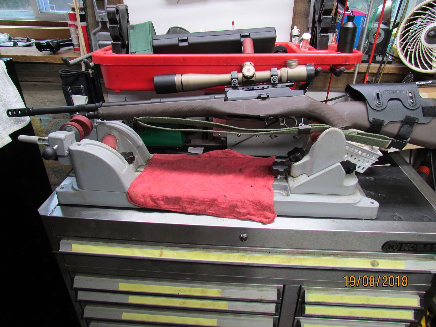

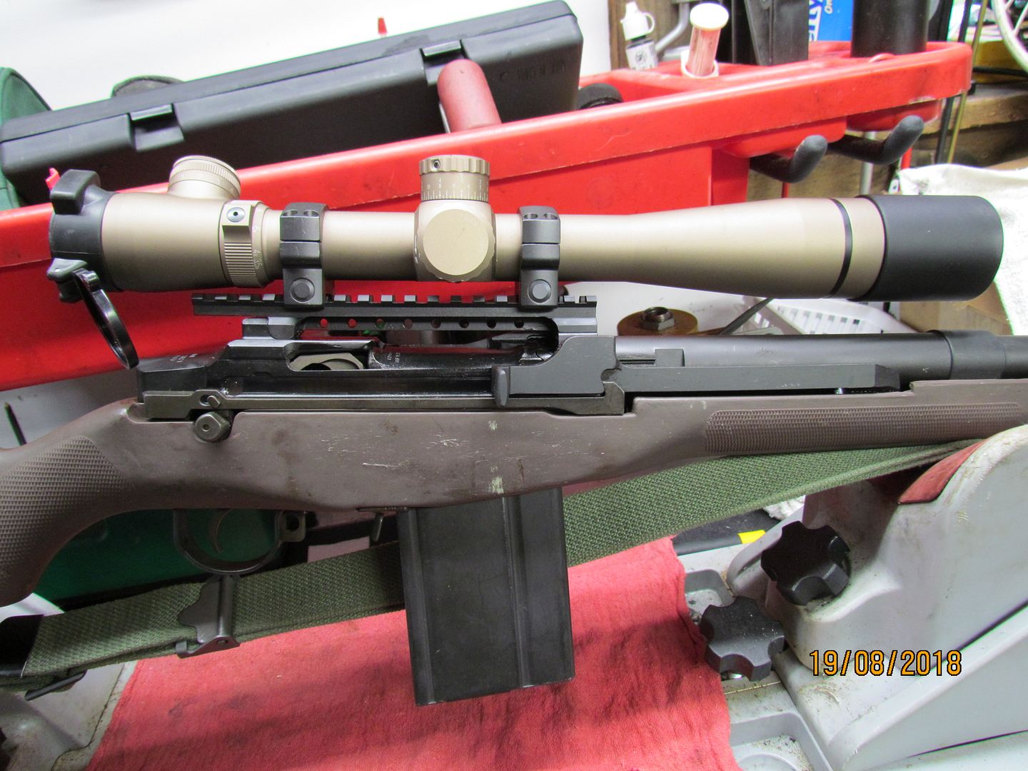

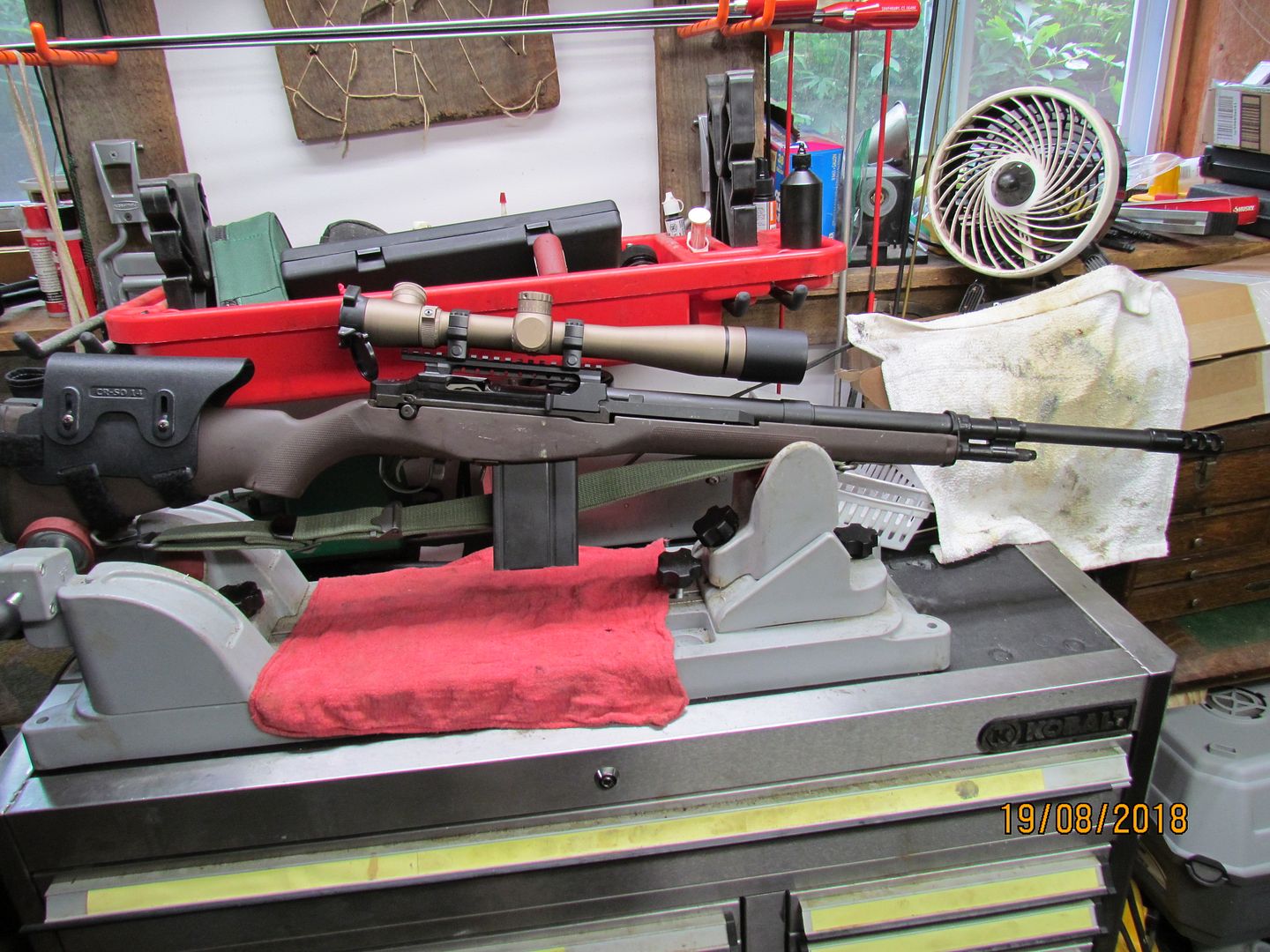

    I was going to wait till a couple of other projects got finished, but curiosity got the best of me. Went down in the shop this morning and mounted the monster on one of my version #1 XM21s. Went together very nicely and I reamed the headspace to 1.633. That barrel is so pretty and " big" , I am going to leave the handguard off for now.
    Ok, using bulk pack , loose M118 LR at 100 yds.
    6 sighters in 2 rnd sets marked 1 - 2 - 3 in order shot.
    Next was lower right 10 rnds in 2".
    Then upper left 10 rnds in 1.75.
    Finally lower left 10 rnds in 1.5.
    For a brand new barrel set in a USGI fiberglass standard stock, I am impressed.Total 36 rnds shot in about 15 minutes.

        This barrel is a whole new critter. I have used the USGI heavies, this makes them look like a pencil. USGI gas cylinders are way to small to fit over the OD of this monster.
        Time for you to get out and do some shooting. You aren't going to do it any younger.
          Getting there. I think a little more polishing on the sharp edge on the chamber and she will feed like whale sno?.

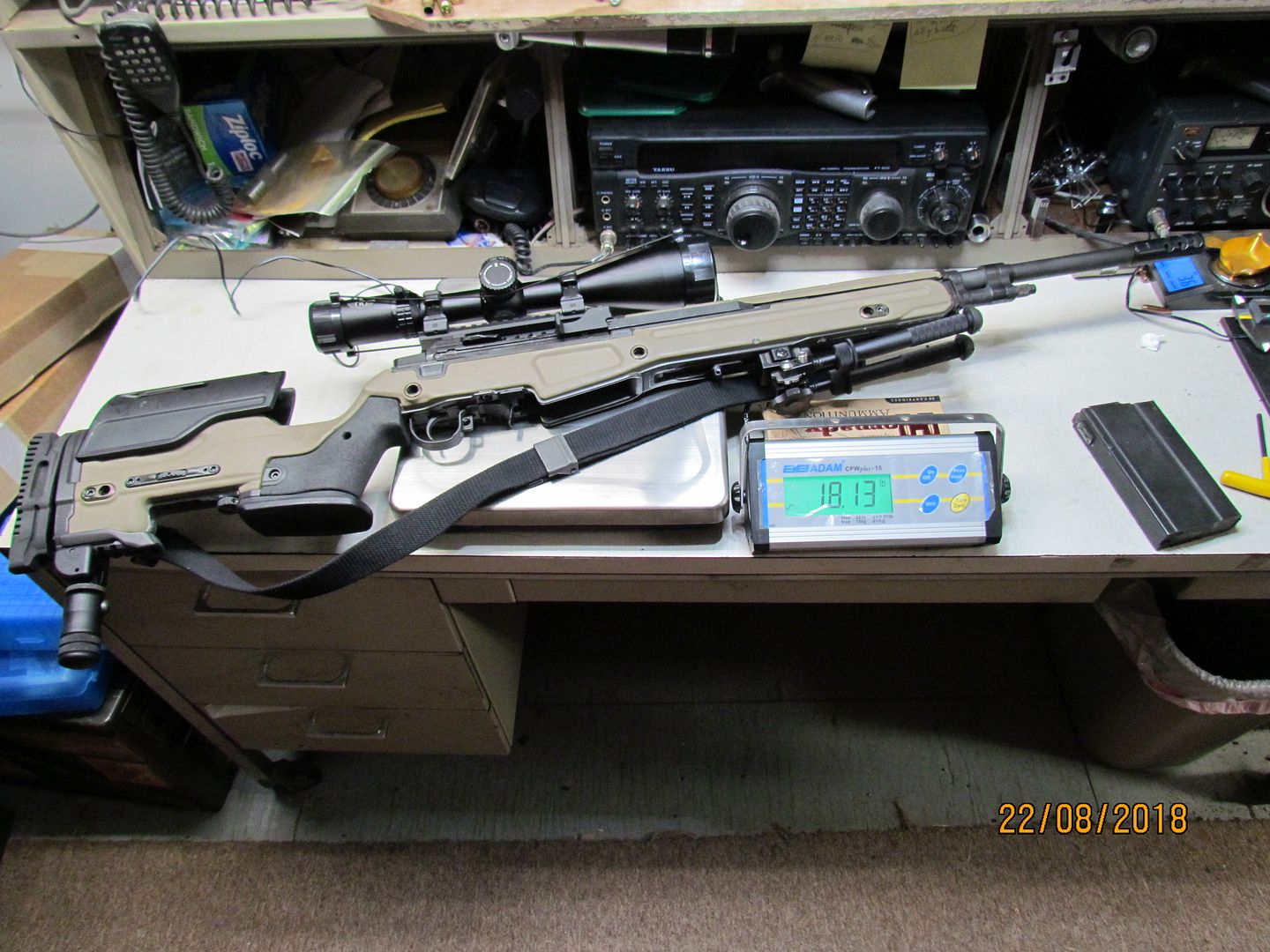

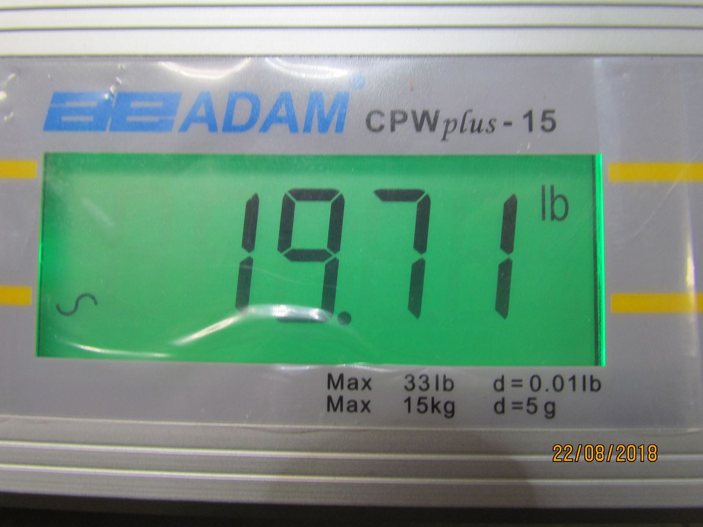

            Weighed in this morning without mag or ammo at. 13.80.That's 2.56 lbs heavier than the .450 Bushmaster in a wood stock.

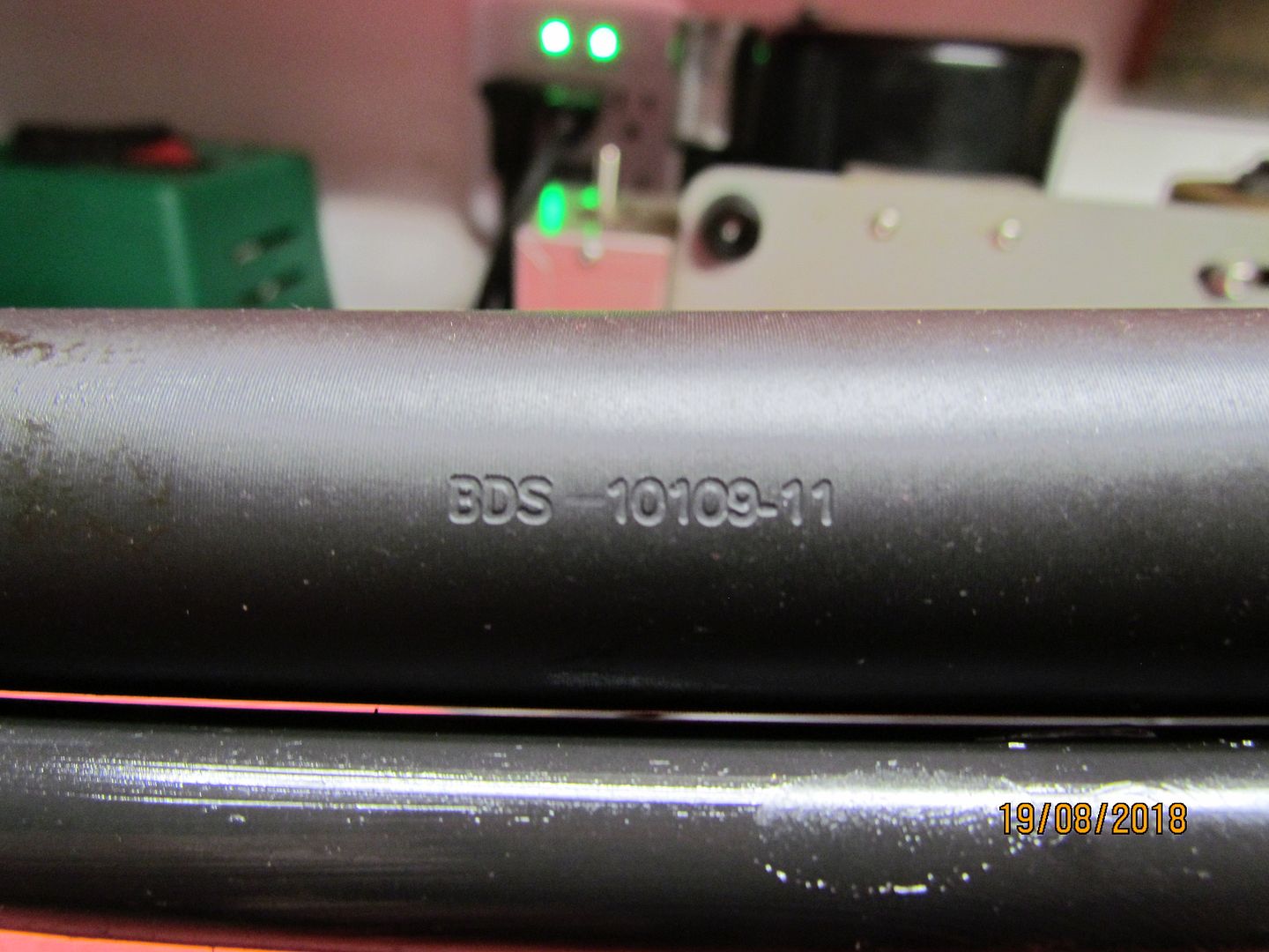

              Very nice. I assume the gas cylinder and op rod guide are commercial ones specially made for the barrel.
                Rgr. entire rifle is built using parts and barrel made by Bula Defense System in Cleveland Ohio.

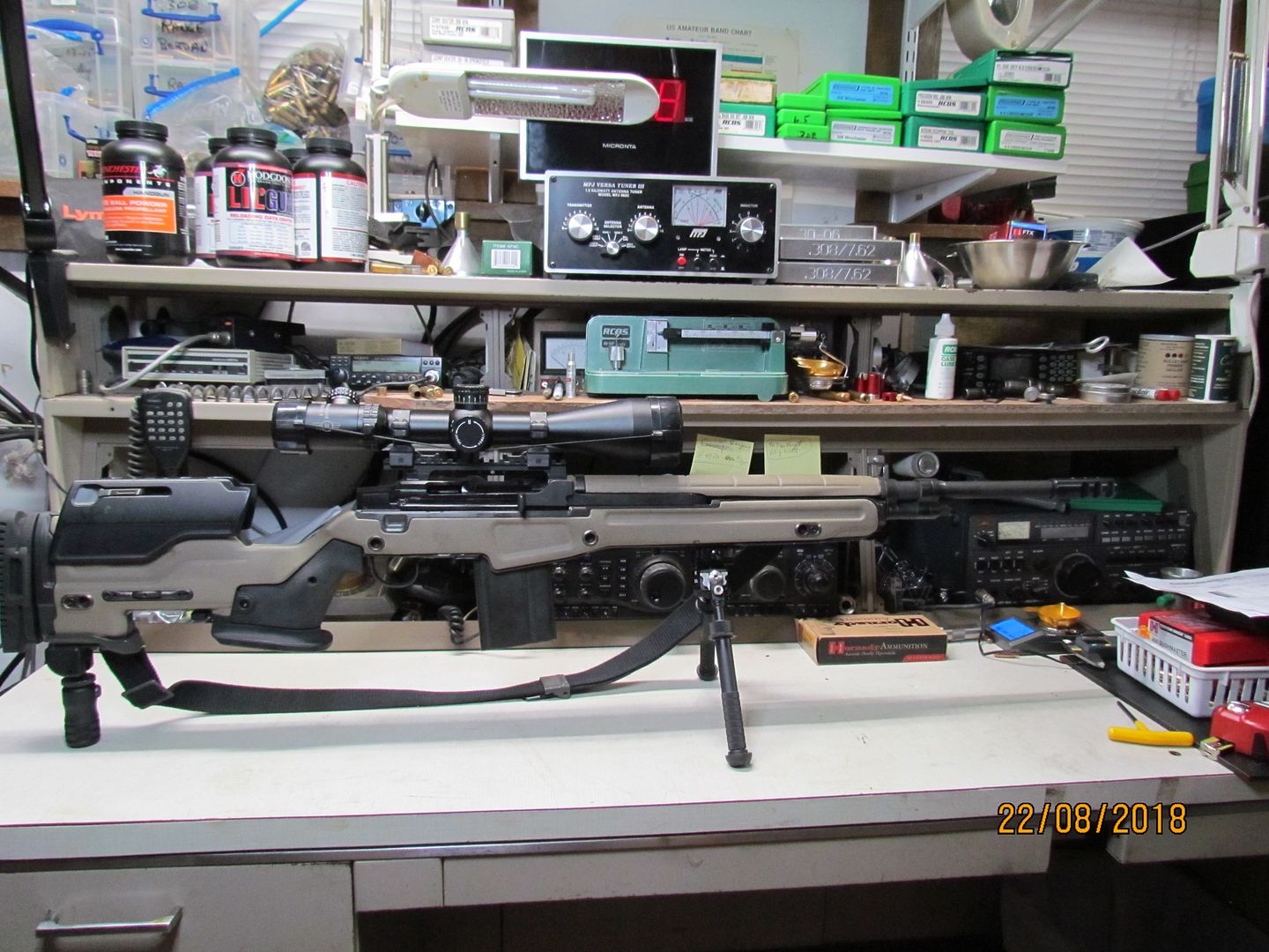

                  Went down in the shop and dropped her into one of my JAE Gen III chassis. Not for snowflakes for sure. 18.13 empty and 19.71 with 18 rnds of M118 in a mag. I can't think of a more enjoyable way for an old fat guy to get some exercise.

                    Nickname it the PIG.
                      Feels about as heavy as an M60 did 50 years ago so that's fitting.
                        Interesting. When you take pictures, don't have such a cluttered background.
                          Rgr. that. Hard to find a place without clutter in my shop.
                          I will try to do better.
                            get a tarp, sheet or similar and use that for a background,
                            hides the 'stuff'
                            btw, that table with the radios is a bit too neat,
                            need to spill some powder and turn over a partial hoppes bottle,,
