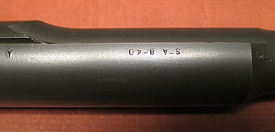

Early Gas Port Barrel
    Another early gas port barrel.
    Gorgeous barrel! Loose or attached to a receiver? Sincerely. bruce.
      Other than the date, what is the difference between early and newer barrels?

        another S-A 8-40 barrel
        This barrel which is also dated S-A 8-40 has London British proof stamps

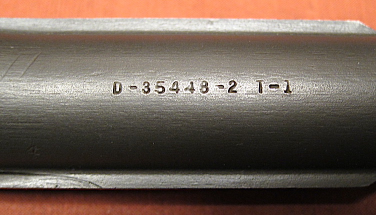

          gas trap barrels
          The gas trap barrel is a few inches shorter than the gas port barrel and without a gas port. the gas trap barrel is made so
          that the gas cylinder is screwed on to the barrel with a single spline cut into the top of the barrel. the front sight locks into
          the barrel to keep the gas cylinder in place.
          Gas trap barrels in good condition are worth around 10K and up if located, this also means that fakes are around. The gas
          trap barrels have a different drawing number. In my photos, the middle barrel is originalP1010024_0023.jpgP1010022_0021.jpgp1010009_0010.jpgp1010014_0015.jpg
            None other than the date and markings, and being virtually impossible to find.
              receiver is in the 52K serial range[ATTACH=CONFIG]51529[/ATTACH]
              Too early for the Lend Lease rifles. Must have come back through England at some later date.
              Canada received about 1500 Colt 1911A1 pistols through Lend-Lease in WW2. After the war they were sold by the Canadian government to an arms merchant and were shipped to England where they were British proofed, and some shipped back to the U.S. commercial market. They have the Canadian broadarrow C property mark on receiver and slide as well as the British commercial sales proofs.
              Loose. Bought it for a September 1940 rifle with a bad bore, but actually a month early for it and couldn't bring myself to change it.

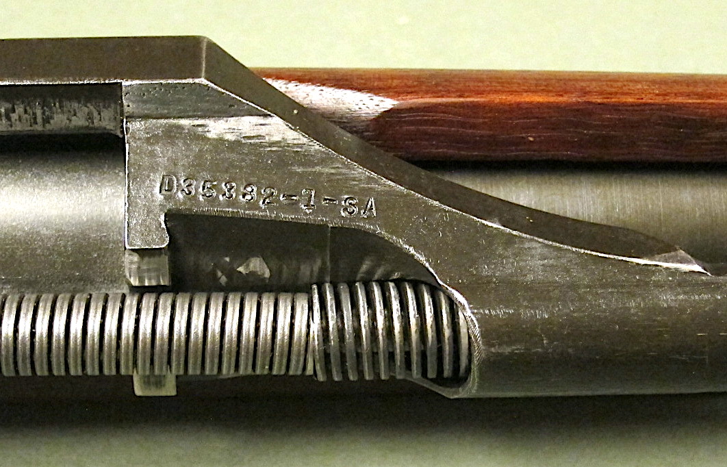

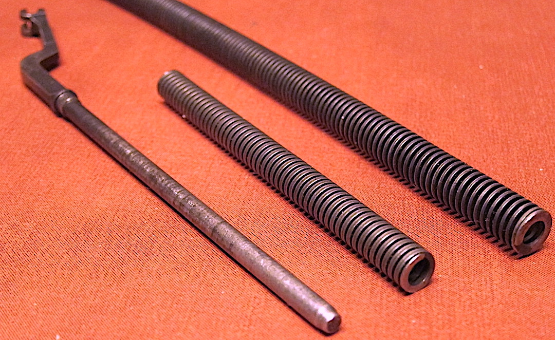

                          Early follower rod with Keystone compensating and recoil springs. The early rifles did not have quite enough oomph to cycle reliably and the follower rod was modified and the compensating spring was added, 1935 I think. The early follower rod had the shoulder for the spring at the front of the rod.

                            keystone and comp spring
                            The first 5000 (approx) Winchester manufactured rifles also had the keystone and comp spring, This was during the
                            first part of 1941. Rifle in photo is a20d9ac2d-8ecb-4a25-912a-2982a5fd4805_0021.jpgd0dca638-3bfe-420e-aab1-7e2c7bfaea23_0023.jpg0aaeb6f0-d77d-4b6a-9384-fb9f4be42968_0026.jpgP1010062_0052.jpg three digit serial number (also pictured in Canfield's book) that was serial numbered
                            on Jan 15th 1941
                            stock is no trap WRA RS cartouche
