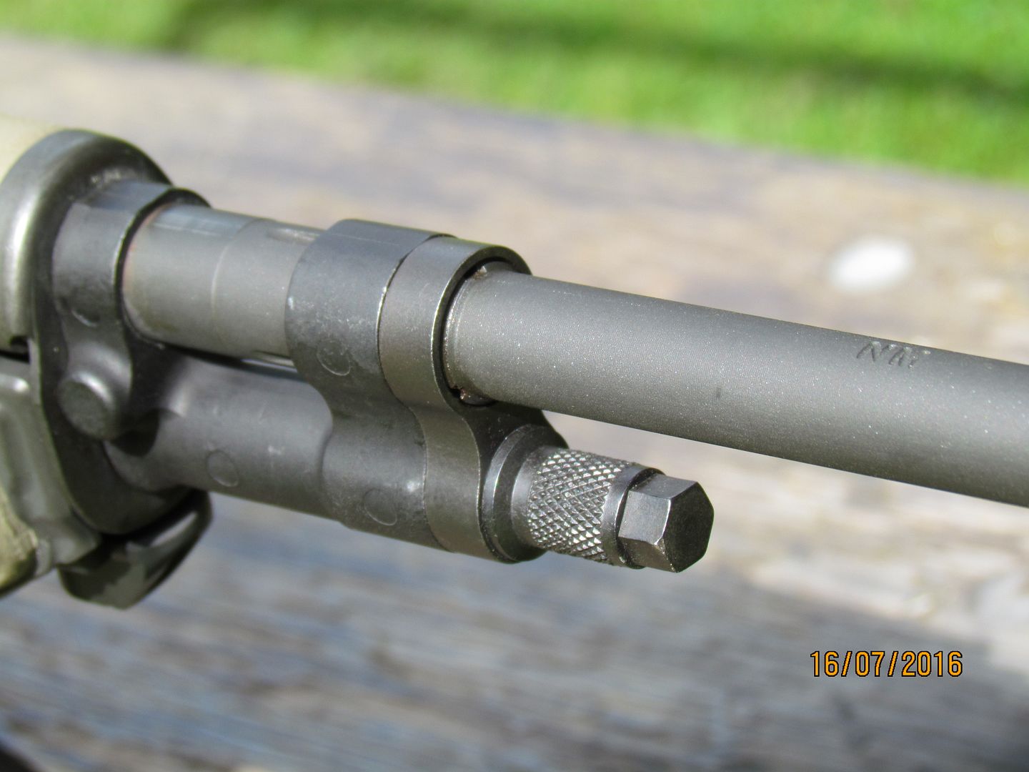

    Check out the gas cylinder, notice anything strange?

          The gas cylinder is sealed no screw for blanks....
            Correctomundo. No gas shut off for rifle grenades. Why bother with putting one on if it isn't needed.
              That is what arty and mortars are for, not to mention the Wart Hog. You never know what can charge from behind the rifle pit. Sounds like I need to be put to bed.
