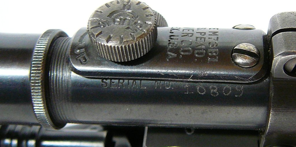

Original 03A4 with possibly original installed M73B1 scope
  • cplnorton
    • 2194

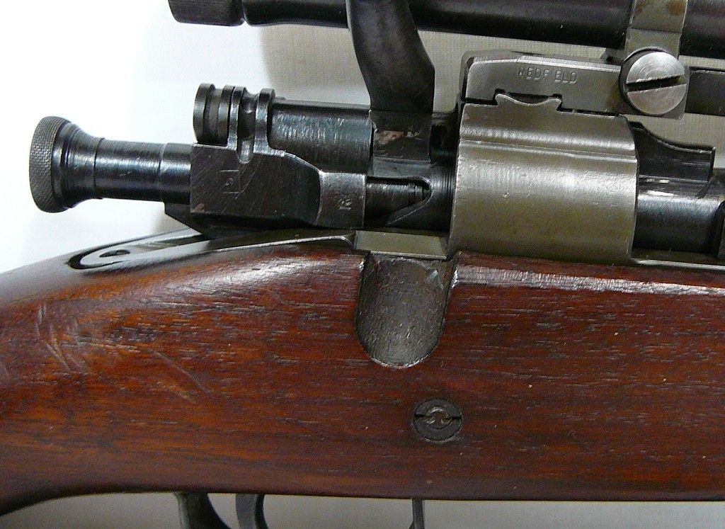

    I think the early ones were cut by hand. But unless I'm mistaken and Jim will correct me if I'm wrong. By this serial range they were just the normal regular cut with 2 sweeping cuts or however they describe it.
    And I almost think it might be the lousy pic under by bright photo lights on the front swivel being refinished. I'm not seeing really any sings in person of it being refinished. I think it's just my photo lights drown out stuff and change colors on items.

        the first 1000 A4s would have a hand cut pre war C stock.. others would be double mill cut
        • jgaynor
          • 1287
          Cpl Nortons rifle was probably about the 10,000th A4 assembled which puts it about halfway thru the first order. It was likely assembled in September of 1943. So not an early A4.
          The bolt notch is an original Keystone manufacture. Keystone supplied stocks to Remington and as spare parts.

                I was thinking of something this morning. If my scope had a sealant around that plate wouldn't it have covered up the Serial No rollstamp and the electropenciled serial? My dataplate covers up a tiny bit of the serial no rollstamp already, so I don't see how any sealant could have been put on it without covering this up.
                I'm not sure who electropenciled the serial on the scopes. I imagine either Weaver or the military. But if Weaver did it they probably would have put the rollstamp and electropencil down further on the tube. And say the military did it, it would for sure have never had any sealant on it because it's electropenciled in a spot that would have been covered.
                    Steve, The scope markings were applied by Weaver. Only place where it was practical when you think about it and Remingon did not have marking in their contract.
                    Not all of the Weaver 330C's or M73B1's had the goo under the data plate. It appears to be a feature that arrived with later production
