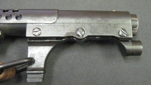

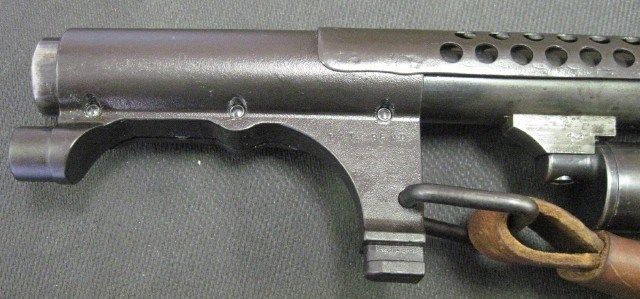

Got an original Winchester handguard attached to faked trench gun. Has patent dates. Can't seem to be allowed to post pics. What might it be worth?
Original Early Winchester Handguard Value
Tags: None
Depending on condition, a patent dated Winchester handguard is worth between $500 to $1000 for someone that needs one. Good item to have. -
Those photos look like an aftermarket handguard to me, and someone has hand stamped the "Pat Applied For" markings into the wrong side of the bayonet lug. The screws are not right either, and are modern production. Looks like a repro handguard on a fake Trench Gun. I would say "pass" if you are getting it just for the handguard.Comment
I was buying it for the gun. The possibility that it might have an original handguard I could flip was just a bonus. Oh well. Thanks for the input.Comment
