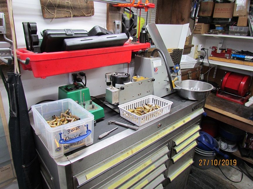

    Ran 500 cases through my Giraud trimmer this morning as the final step in brass preparation. They are now ready for priming later today. Only takes about 1 second per case with the Giraud. Whatta Hobby!

    Trimming should be the second step if it's required. First is checking lengths with a vernier. Then chamfering and deburring after, but you only trim if the case is longer than the max case length. It's not a 'regular' thing.
    Spelling and grammar count!
      the good thing about a Giraud and a Gracey is, you don't have to measure each case,
      you set the machine to cut at the correct length, (press the shoulder of the round into a 'die' or sorts) and the trimmer trims if necessary,
      if it is still a bit short, then no trimming done,
      when I was shooting service rifle, I ran my brass thru a Gracey trimmer about every 2-3 reloads, (very little stretch)
        It is for me. I run all my brass over the Giraud, just in case a long one got in the mix. Only takes a second. Last step after the second trip through the Thumler and dryer. I also anneal more than most, but I am a stickler for neck tension.

          "...you don't have to measure each case..." You don't with a vernier either. You lock it at the max case length and use it as a gauge.
          No need to clean more than once. Annealing isn't a regular step either. It's only done when you get one cracked case.

            After 50+ years at this stuff, I have found what works for me. Even my generic loadings get better treatment than my dog and the precision, better than my wife. I clean the cases first , before sizing and a second time after sizing to remove lube.

                  Well, just so happens the Giraud trimmer does the chamfering of the inside and outside of the neck as part of the trimming operation.

                        No computers, it is completely mechanical as is the Giraud anealer.
