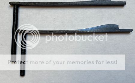

            First time I’ve had them out of the stock.
            • Fred
              • 4977
              #66
              Here is a sharper photo...
              https://hosting.photobucket.com/images/c72/Whitedog333/127114A0-1F64-41E2-8DE9-C700D6F669FA.jpeg?width=450&height=278&crop=fill

                I think that design of band spring was used by Springfield Armory on their Model 1861 rifle Musket’s and 1865 breech loaders. That would make it an 1855 design.
                Maybe it was thought to be easier to use the 1864 type springs on the 1868’s and when necessary grind down the high hump 1855 springs to conform to the later 1864 design than to use and eventually exhaust the supply of the 1855 type and then have to begin producing them?

                  Maybe the change in 1855 to 1864 band spring design was not thought to be of enough significance to’ve been listed as an important change., but the decision was made in 1868 to adhere strictly to one type of spring and that one to be the type of spring that had been used on the 1864 and 1866 long arms and to alter, if needed, the shape of existing 1855 band springs still in inventory to the 1864 shape.
