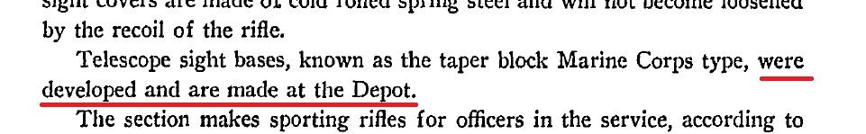

                    But back then the official names of these blocks were Mann Tappered blocks. The Marines only called them Tappered blocks.
                    I can provide a document from the period where the Marines refer to them as "taper block Marine Corps type". The following is from a Marine Corps document. (The system will not let me post the clip - will try again later).
                    As far as WRA using the Mann Neidner blocks, everything I have read on the WRA side and the actual Marine documents. I am pretty convinced that Winchester did not use the Mann Neidner blocks. All the detailed contracts and even the actual Wincehster pictures from this time show them using another block that they had named the Springfield Marine Block.
                        Jim look at exactly what I said. I said there is NO proof that Winchester used the Mann Neidner, or a tappered block. When did I EVER say Philadelphina Depot didn't use them? And I said the Marines called them Tappered blocks. Well how is what you are saying any different than what I am saying? Everything I say in this post is about the rifles done during the 1917/18 era. Post WWI is a totally different era in the A5 history.
                        Now you come back and say you have proof from a document. Well Jim I'm the one who sent this out to everyone back in Febuary, so I am quite familiar with this one. First it's not NOT a Marine document as you state. It's from the Marine Gazette or Leatherneck Magazine dated Dec 1925, that is talking about the currect activities at the Philadelphia Depot. So it's not the official document you portay it to be. It's a magazine.
                        And what you haven't figured out in all this Jim, and I said this earlier, is they never stopped putting A5 rifles together. From the Marine team docs, it looks like they made them as needed, and they were still building them as late as 1941 for the training.
                        There is not just one tappered block out there Jim. This is a big clue to all of this. And as I said the Marines called them Tappered blocks. But that isn't what Winchester called them.
                        If you are going to imply that you have some kind of proof that WRA made a tappered block design, you might want to make the Magazine doesn't say the tappered block design was developed and made at Philadelphia Depot.
