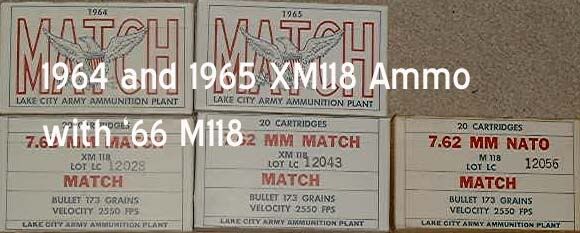

            The 7.62mm Match M118 cartridge was first approved for production in August of 1964 with the earliest runs produced at Frankford Arsenal. Since Frankford's closing Lake City has taken over all production, giving the ammunition its nickname of 'Elsie'. No relation to the Borden Company's 'contented cow', this homophonic simply refers to the cartridges’ head stamp, 'LC'.

            The introduction of 7.62mm was heralded by a 1964 production run at Frankford using the familiar buff box design. The cartridge was designated as XM118 with a velocity of 2550 feet per second. The next year Frankford produced the ammunition with the buff box design and the cartridge's new designation of M118 while Lake City's 1965 white box design interestingly enough indicated that the contents were XM118.
            M118 Match began rolling off of the production in white boxes. The year of production was noted by either having the year printed in red over the eagle logo or having the lot number, which first two numbers usually mirrored the last two of the year, stamped on the front just below M118. While this ammunition was a fine cartridge, it was impossible to stop shooters from tinkering with it to improve accuracy. As the military had the most ample supply of the ammunition the search for an extra edge started with them. For some time it was popular to take a pliers type reloading device and break the bituminous seal between the neck and the bullet in the belief that this would make the force needed to separate the bullet from the case more uniform. This was, of course, against the rules when the ammunition was being fired in an EIC or National Match.

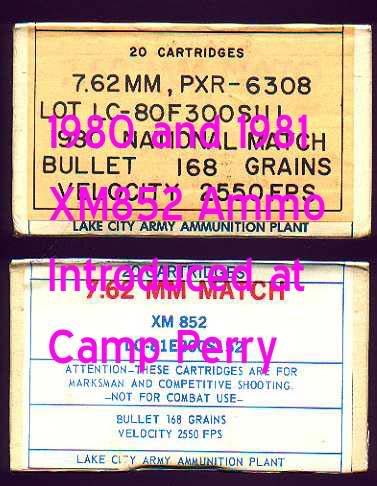

            In late 1979 and early 1980 rumors were ricocheting through the service rifle community about a new match cartridge to be issued that was a duplicate of the Mexican Match. There was a buzz of excitement at the ammunition issue points during the 1980 National Matches when the green metal cans were broken open and shooters were issued, for the first time, pasteboard boxes containing "20 CARTRIDGES 7.62 MM, PXR-6308 LOT LC-80F300S111 1980 NATIONAL MATCH BULLET 168 GRAINS VELOCITY 2550 FPS". A buff colored printed label covered the traditional white LC box. The top carried the usual disposal directions while the back side told that the contents were "SPECIAL MATCH CARTRIDGES FOR USE IN COMPETITIVE MATCH SHOOTING NOT TO BE USED IN COMBAT” The hollow pointed bullet, so accurate in competition, is forbidden, by the Geneva Convention, for combat use. To further identify the cartridge there was a cannelure that ran around the circumference of the case a short distance up from the base. There was much concern among the civilians that the shallow grooves would weaken the case and make it useless for reloading. The concern was not great enough to stop them from snatching up the gleaming bottleneck cylinders, almost before they stopped bouncing and steaming, from the dew dampened grass.
            The ammunition proved very popular and was produced in 1981 as 7.62mm Match XM852. The LC boxes were still covered with a paper label but this one was in the traditional colors of red, white, and blue. However the familiar eagle had been dislodged from his perch and the word 'MATCH' was found in large hollow block letters on the back. The warning had been changed to "ATTENTION-THESE CARTRIDGES ARE FOR MARKSMAN AND COMPETITIVE SHOOTING-NOT FOR COMBAT USE-". In 1982 the ammunition was designated as M852 but still issued in a box with a paper label. By 1984 the new ammunition was packaged in its own Lake City box. The outline of a center fire cartridge, with an anachronistic round nosed bullet, faces nose down on each end flap. By 1991 the white box, American Eagle logo, and the case disposal message had passed into history, replaced by a plain brown box that carried a simple black frame on its front that enclosed the words, "20 CRTG. 7.62MM MATCH M852 NOT FOR COMBAT USE", on three lines, and a stamped lot number while the end flaps retained the round nosed cartridge motif.

            • Chris F
              • 40
              #36
              Wow...
              More pics

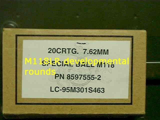

                    I recall when the CMP was selling M118LR, and there was much discussion as to why it was being surplussed, and why some boxes had mixed year headstamps. I recall that my friend who was Commander of the AMU during that period a former SOCOM Sniper speculated that the ammo had been found to be out of spec or improperly stored. I believe that the most credible explanation of the mixed headstamps was that Lake City produced brass in batches. When a lot of ammo was loaded, whatever brass was left from the previous cycle was loaded regardless of year headstamp, them the current production brass was used after the old was exhausted. That of course was all theory. An alternative theory for both situations was that ATK, the contractor running the Lake City Plant collected all the odds and ends leftover and produced ammo specifically for resale. This was supported by the quantities of M118LR that was being commercially sold in plastic bags or in brown boxes with special labeling that was similar to, but not quite issued M118LR.
                    Since you brought up LR, here's a pic of the box from the prototype LR. LR was unique in that it was a USMC project.
                    Did you know that that 175 Sierra MK was designed for the M118LR project? One of the major design criteria was a bullet that would remain supersonic at 1000 yards (something the 168 couldn't do out of a 24" M40A1)

                      Chris the story I got off the firing line with Texas NG team shooters was that the 175 MK bullet was designed to function in the M14/M21 sniper rifles 20" barrel and stay supersonic. The 180 MK caused too high a pressure at the gas port on an M14 in hot weather. DOD was preparing way ahead for a Desert war. You know like in the Desert of Iraq! I tried to use 168 pushed on some M118 SB loads. AKA "MM" and it was not reliable past 900 yrds. in an M1A 20" barrel, bullets started to keyhole. FWIW
