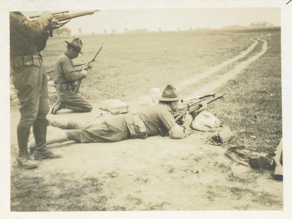

      Take a look at this one, Steve. It is from an old post, (JB's as I recall), and the pic was taken in France. Take a long look at the rifle on the far left in the stacked arms. It is a Winchester modified scope (big knobs on 7.2" centers - sounds like tits). It can only be one of the 150 Niedner rifles.
      jt
      • Fred
        • 4977
        #48
        I've got that photo on a Stereo optic card.

          Yeah I have that pic too, that is one I have been working on with the WWI guys on picking their brain. They think it's probably the 5th Marine Regiment in France. And yeah I think it's probably the Mann Neidner too. I wish the pic was a little better.
          But Neidner converted the 150 rifles in May/June 1917. Some had to go over. That was pretty early still.

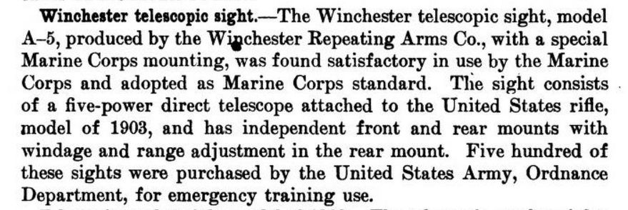

                This is my last piece I have found so far. This was in the Handbook of Ordnance Data. And it’s dated November 1918 I think if I remember right.
                I think this is what has thrown people off. I think at this time, there are two distinct Marine Mounts for the 1903. One that was created by Neidner, and one that was created by Winchester. These scopes are coming from Winchester, to the Marines. And if you take the sentence and break it apart and read it like this, “Produced by the Winchester Repeating Arms company, with a special Marine Corps Mounting”
                I speculate that those 500 coming to the Marines from Winchester, had the Winchester Marine mount, like the one drawn above in Brophy's book. Neidner had the control of the tappered base from everything I can research, and I think Winchester wouldn't have wanted anything to do with it anyways. To me, especially back then, if he was under investigation by the FBI, and they were worried he could have potentially sabotaged those rifles. I just can’t see them letting him back in to Philly to convert anymore.

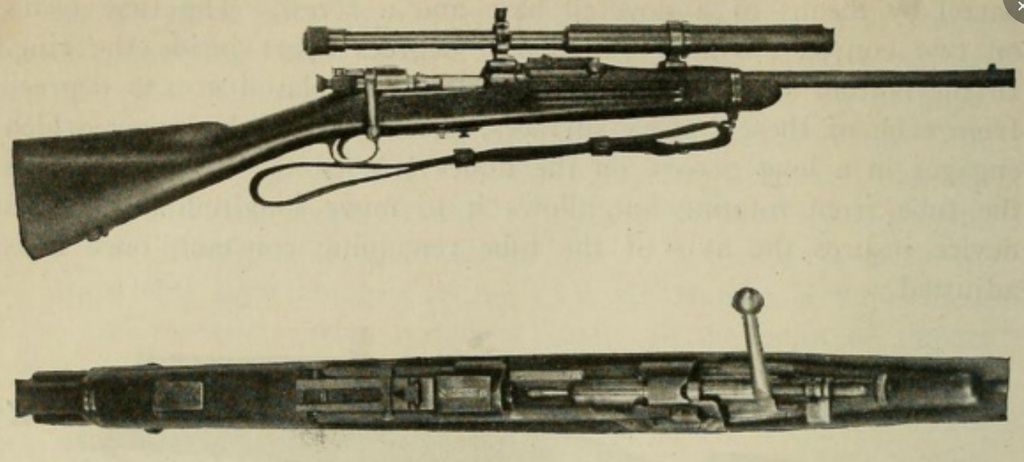

                      This is the pic in Whelen's book. But notice the base on the rear receiver is shorter? It doesn't really prove anything at all, but it's a neat pic of a Neidner rifle from the time period, so it might be a useful picture to compare, if we can ever find some really good pics of one we suspect Neidner converted at Philly.

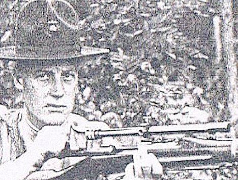

                        I thought I would post real quick a couple of pictures that I think are interesting, before the wife drags me away for the day. lol
                        I think someone posted this picture several years back on milsurps. In fact I think JB and you (Jim) were trying to figure it out back then. This is one of the next ones I'm going to throw up to the uniform guys and see if they can date it and tell me more. But the rifle seems more like the style of mine but it is so hard to tell any details, especially on the mpunts in this pic.. All i can say is, it does not appear to be a Mann Neidner to me.
                        This pic might be a early pic, especially looking at the style of boots on the man to the left. But I think one of you pointed out back then that the snaps on the cartriage belt might be later. So I'm going to throw it up to the uniform guys and see if they can help. The rifle has a low wood stock and it looks like the large knob on the windage, so I think that at least dates the rifle after the 1910-11 timeframe. But you guys know way more about the 1903 rifle than I do.
                        Also I found this one in a post that I think you made. This again looks like one that is like mine. You might be able to date this.
